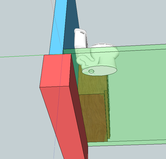

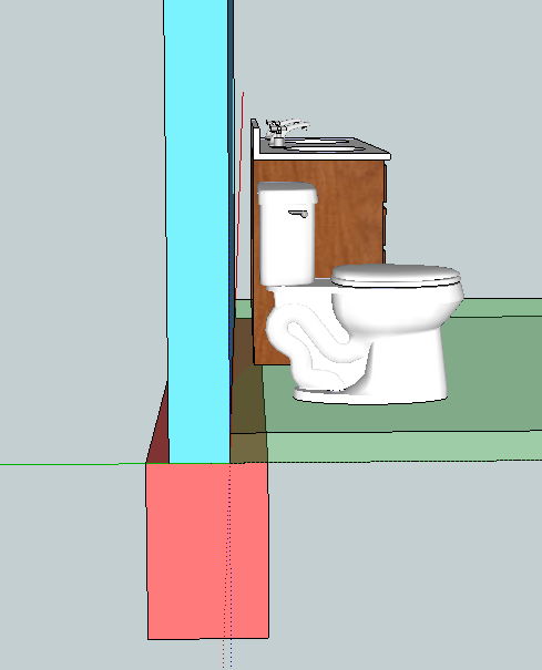

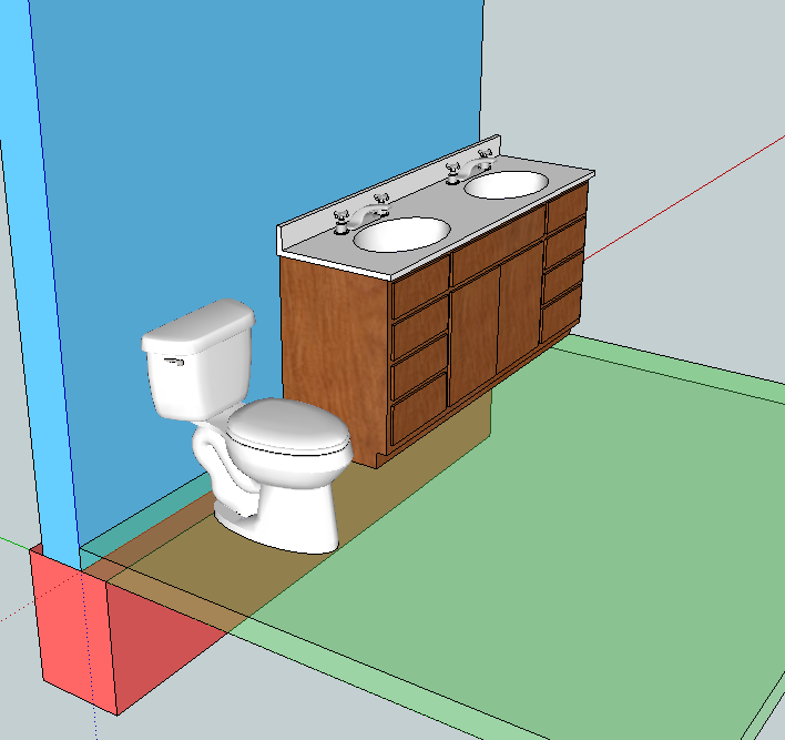

    I am having a licensed plumber do a new bathroom. He is a good plumber, but somewhat unimaginative. There are some quirks involved and I would like to have some ideas and options to offer him.
    In the drawings below, the blue wall is an existing concrete block wall. The red is a concrete footing. The green is a soon to be poured concrete slab that is a new bathroom addition. There will also be a 2x3 (3" finished thickness) stud wall against the concrete block wall.
    The issue is that the footer extends out 5" past the block wall. What is the best approach for getting the toilet and vanity vents into the 2x3 wall? My only thought is a couple of 45's. Since the floor is just 4" thick, even 45's might stick up out of the floor a bit (but it may have to be).

    no need to vent the toilet separately you can wet vent the toilet with the vanity. then your plumbing will be behind the vanity and you wont even see it if it sticks out of the concrete
    23,507
    Put the pipe behind the lavatory. "Knock" the edge of the footing off and put the drain/vent line on a 45. It will be above the floor, but UNDER the cabinet floor, so it will not be visible.
