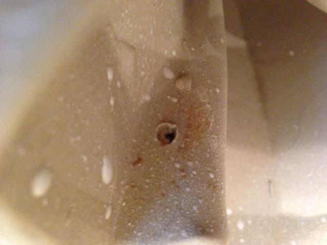

Clean the flange off well, and then check to make sure that it isn't cracked. While a pain, have you flipped the toilet on its side to check and see anything? Some people have reported casting defects that were filled (poorly), and they either fell out or never were made properly in the first place.

Yes, I looked at the bottom of the toilet thoroughly. I have not seen any moisture on the underside of the bowl part.
The flange is not cracked. There are however burs on the flange, but they are below where the wax would sit.

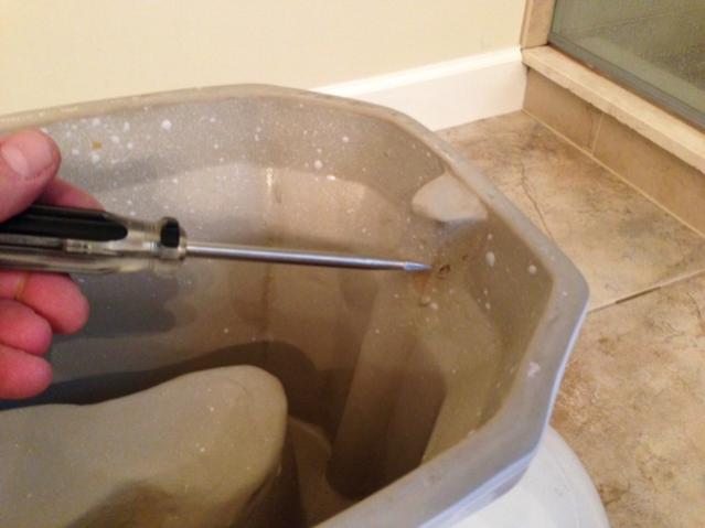

So I found the problem. El cheapo is correct.
There is a hole I am pointing to with my screwdriver.
I contacted the company and the toilet is out of warranty.
What do you all think if I plug that hole up with a big wad of wax? I am sure that will stop the leak for a while, but definitely is not the correct way to do it.

I'm going back on my vow to leave this thread alone, but the best solution to this problem is an 8 lb sledge hammer. Then get a Toto Drake and live happily ever after. Wax plug? Maybe as a very temporary stop gap measure.

You might try some Silicone on that. It seems a little odd that water is leaking there, but then I've seen water leaking out of the front of a bowl on the outside, kinda near that location. That was on a brand new bowl installation. Your leak, being on the inside was harder to find.

Thanks Terry for posting the picture and the reply. Do you think silicone will hold up better than wax?
I hate to have three different types of toilets in the house. My other toilet is a Mansfield Barrett, which I like a lot but hard to find locally.

Ok, I'm gonna try JB weld - Waterweld. Heard good things. It's worth a try, although it isn't very professional!

If it works, you have saved yourself $200. If not, Gary's sledgehammer idea would probably at least be kind of fun given how much work you put into finding that hole. I take it that the orange-ish moisture near the hole is food coloring. It's amazing how much the dye test helps because if I saw that hole without the dye near it I would probably just assume that it was part of the casting and in a location that it wasn't likely to be the problem.
If you do need a new toilet, the original Drake is now a very good buy in that price range, given the quality of the build and the effectiveness of the flush.
