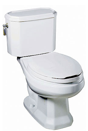

    Hello all. I'm a DYI'er and new here.
    I am having a heck of time trying to get my toilet to seal at the flange.
    First issue, the closet flange sits about 1/2" below the finished floor.
    Second, the collar on the toilet has two grooves where the "p trap" is, recessing upward toward the tank.
    In other words, it is not completely flat where the wax ring sits.
    Has anyone else had this problem with a toilet?
    The original problem was that there was a small amount of water leaking from underneath the base. The baseboard(mdf) was swollen from water damage. It has been replaced.
    I tried the following;
    1. Two wax rings. Still leaked
    2. Flowmaster wax free. Still leaked
    3. Two 1/4" spacers with wax free. Still leaked
    4. Two spacers and xl wax ring. Still leaked.
    My next try is to fill the two grooves in the bottom of the toilet with some left over wax then use two wax rings along with the two spacers. What to you all think? I have examined the heck out of the toilet for cracks and cannot find one.
    Maybe thinking for trying the fernco wax free, but don't think it will work because if the two grooves.
    If none of this works I may just buy a new toilet and try that. I don't really want to since the toilet is only 4 years old. Plus I have three more of these toilets in the house. The other two rock and move. So I will be replacing those rings too. The toilet is called "rivers edge".
    Any help would be great.
    Thanks.
    Tom

    The pros will doubtless have a better insight than I, but my first reaction is that if your drainage pipe is clear and functioning properly, you shouldn't get enough water "leakage" from flushing into it to damage the baseboard over the relatively-short time period that you are talking about. Also, if you are using enough wax, if I understand your description correctly, I don't see why the wax wouldn't just compress into the ridges that you are talking about and provide a sufficient seal. Do you have any specific reason to believe that the leakage is coming through the seal between the toilet and the flange? Could it be coming out from somewhere under the flange (i.e. cracked drain pipe) or above (cracked toilet, as you mention)? Have you tried putting some dye in the bowl and seeing whether it propagates through a bowl crack anywhere?
    Sorry I can't be more helpful.
    PS Which rivers edge model do you have? There are photos at the manufacturer's web site which you can find with a search engine.

    It is a Whitehall lane elongated toilet. I will try to take a pic of it later.
    After each of my four attempts, I slide a piece of paper under the toilet flushed a few times and pulled it back out. It is all wet. I made sure the area was dry before set the toilet.
    There is no damage to the cealing below the toilet so I think the drain pipe is ok.
    I'm sure there is some small amount of damage to the subfloor, as well as the cement board. But I don't think it warrants me to rip the floor up.
    I was cretain the two wax rings would have worked because I compressed about 1 1/2" of wax but it didn't.
    I didn't try the dye. I will on my next attempt.
    I put paper on both sides and in the front. The piece seems to get wet but not the sides. Maybe there is a hairline crack.
    If I do get a new toilet I'm thinking the Toto Drake.
    Really hope I don't need to shell out another $200 for a new toilet.

    Let state right up front, I'm not a plumber, so there are many things I am not familiar with. That said, I have never heard of a Whitehall Lane toilet and I have been on this forum for years. I suspect that may be part of your problem. Second thing, a half inch recess is a lot to compensate for. Not saying it can't be done, just a lot. If it was mine, I redo the flange and get it on top of the finished floor. Third. If your other toilets rock and roll, their seals are also broken, just not showing a leak. Any Toto would be a wise choice. The Drake is a favorite because it is less expensive than many of the other models and it work extremely well, but at least examine the other choices for their appearance and consider redoing the flange.

    First, as was mentioned, but you may have missed it, if a toilet rocks, the seal will break. Wax isn't resilient...once compressed, it doesn't spring back, so, you must ensure that the toilet is shimmed, if necessary, so that it is rock solid once smushed onto the floor. And, when you set it and compress the wax, try to do it fairly evenly IOW, don't push it down all the way on one side, then the other, either both at the same time, or a little back and forth. The wax shouldn't care if there are small ridges on the horn of the toilet - it should mold itself to that and seal, but if it rocks, all bets are off. The waxless seal may have had problems with those, but wax won't.
    So, the best procedure is to set the toilet down without wax. Figure out where you need shims to keep is rock solid, then lift up again, set the wax, then set the toilet back down onto the shims so that when it is fully down, it won't move. If that fails, the toilet may be defective with a leak, or if it is a two-piece, you may have a leak between the tank and the bowl, or the fill valve seal may be leaking.
    If you shut the water off, does the tank empty after sitting for awhile, or does it stay full? If it stays full, it's not leaking (obviously!). But could when you flush if the seal between the tank and the bowl is either not tight enough, or defective.
    12,429
    Any bowl will leak it it rocks.
    Pick up some shims at the hardware store.
    Check to see how the bowl fits without wax; does it rock?
    Next install with two wax rings set on the floor. Shim the back to keep the front of the bowl tight to the floor. When the bowl is stable, then you can snug the nuts down.
    Finish by caulking almost all the way around the bowl.
    A bowl that moves will always leak.
