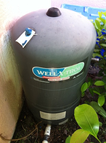

Hi All,
My sister bought this house that came complete with well irrigation system; everything works fine until last week. I don't know much about well irrigation system, so please forgive me if I sound un-educated in this field. As the title stated, the irrigation system stop working after the breaker jumped. It rained for couple of days straight and the ground was really wet. The breaker for the switch valve jumped; I turned it back on but it jumped again so I just turn it off and let everything dry out before attempting the investigation.
I looked over the system today and this is what I have...
My question is, does the switch ever go bad? I did some search on the site and found sticky showing a switch valve with a switch on the side indicates "auto, on and off" and as you can see mine, does not have a manual level switch.
I know the pressure gauge should be replaced because I can't read it at all; if I am to replace the pressure gauge, what range of psi read out should I get? I think the pressure is reading "0" at the moment.
By the looks of thing, I don't think there's any pressure in the tank either. How do I pressurize the tank again? I have a compressor, can I use it to pressurize the tank again? If so, what pressure should I inject in to the tank?
As mentioned earlier, I have no knowledge in this field so any suggestions are greatly appreciated.

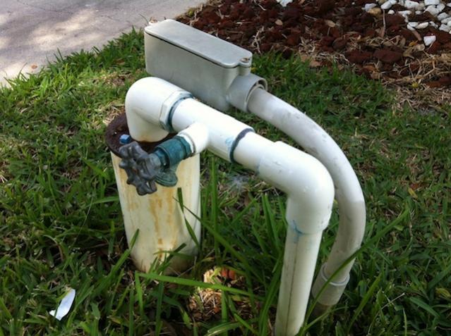

Now that everything is drying out, I turned the breaker back on; it does not trips. Also, when I plugged in the switch valve nothing seems to be happening (clicking sound). This leads me to guess the switch might be bad and need replacement. There are sand and dirt inside the switch valve, I'll use the compressor to clean it first and see if this help. Pump removal is my biggest fear!!! Any idea how much one of this cost (rough estimate)? I have to look on how to remove the pump, the metal cover plate on top of the well is rusted pretty bad. The plate comes in two hafts and I think there used to be some bolts (4) on top, but it rusted out as well.

WHOA!!!!!!! Some of those well seals are have 4 pieces of steel with a rubber disc that expands when those bolts/nuts are tightened. Taking those bolts/nuts off can allow 2 of those pieces to fall into the well and trap the pump.
It sounds as though you have a short someplace. Shut the breakers off & check for shorts and continuity on the lines from the breakers to the top of the well and then from the top of the well down to the pump to determine where your problem is. Checking the resistance through the windings and a check of the start & running amps with an amprobe would help in determining the condition of the pump and motor as well.

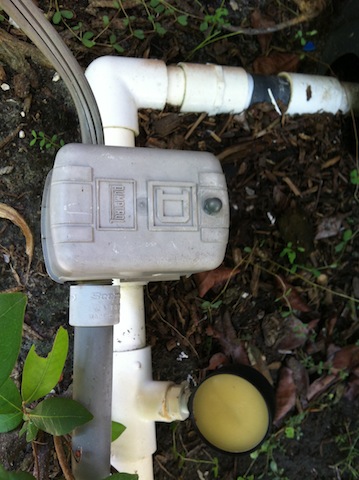

I have never liked seeing a pressure switch out in the weather, see if you can relocate it inside to keep it from getting wet. Also bugs are known to get into them and prevent them from working properly.

If I were to remove the pump, I only way I can do this is to cut the 4" PVC casing; the 4 bolts holding the cover plate as you explained are gone. The head on those bolts completely rusted out.

2. The pressure switch is 40/60 square D

i agree, most likely short in an underground wire. being as it seems to be worse in wet weather, check the wire from plug to switch (assuming wire from breaker to plug is good) and from the switch to the well head before you start tinkering with the well.
if you do need to get to the pump. cut the line at the well head, twist it a little and you'll know how tight the seal is. carefully see if u can pull it up a little through the well seal. looks to be hung on glued pvc, so maybe its not set all that deep and you'll be able to pull it by hand. many times those bolts on the seal arent super tight anyway. i have dealt with some pretty bad seals. if you can get someone/something to pull up on the pump line, you can likely pry it up with a good strong flat head screwdriver or similar. if you can find a big pipewrench and twist the well seal some, that will help. might not be a huge job, but u know how that goes. wouldnt be crazy to call for help.

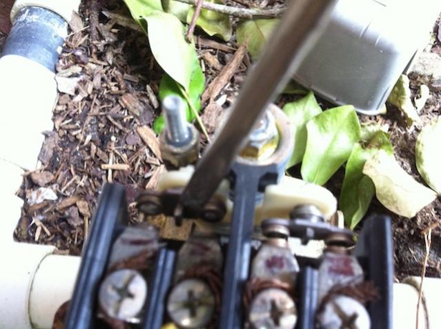

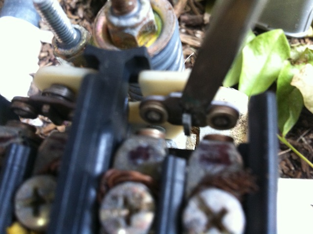

I checked the continuity from the plug head to the PS, all wires are fine. I then checked the continuity for the wires going from the PS to the pump and all the wires are fine. While I was at the PS, I poked around and saw these... There seems to be some sort of built up on the faces of the contacts; is this normal? Can I clean it out or replace the PS? I know this may not solve my problem, but I have to take one step at a time.
Thank-you for all your help and patient.
Craigpump
2,436
158
63
Yeah they get like that after a while, if they get too bad they won't make contact and direct current to the pump. I would replace it. Be sure to wire it up the exact same way it comes apart.

Thanks, I'll replace it... Also I looked on Well-X-Trol website, their tank is pre-pressurized @ 38 psi, I checked my tank and it read 20 psi; again, is this normal? Do I need to add pressure and bring it back up to 38 psi? My tank is rated 125 max psi.
Valveman
Cary Austin
14,626
1,302
Lubbock, Texas
cyclestopvalves.com
Yeah 38 PSI air is correct for a 40/60 pressure switch. Points burned like that is the first indication of too much cycling on and off. Cycling causes you to need the replace the pressure switch a time or two, then it takes out the bladder in the tank and the pump/motor next.
