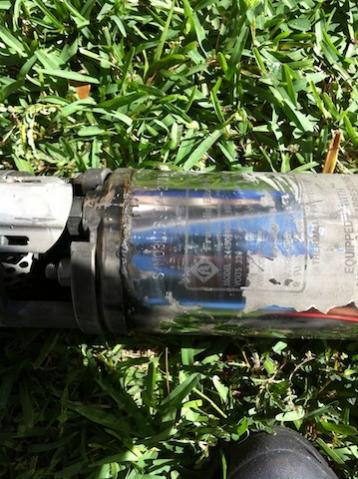

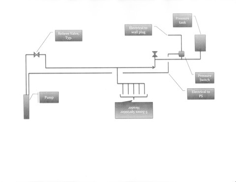

    To the best of my knowledge, this is the P&ID for the well system. From cyclestopvalve.com web site, discharge (sprinkler header) should be after the pressure tank? If you look at the first set of photos, you'll notice one line go to the tank.

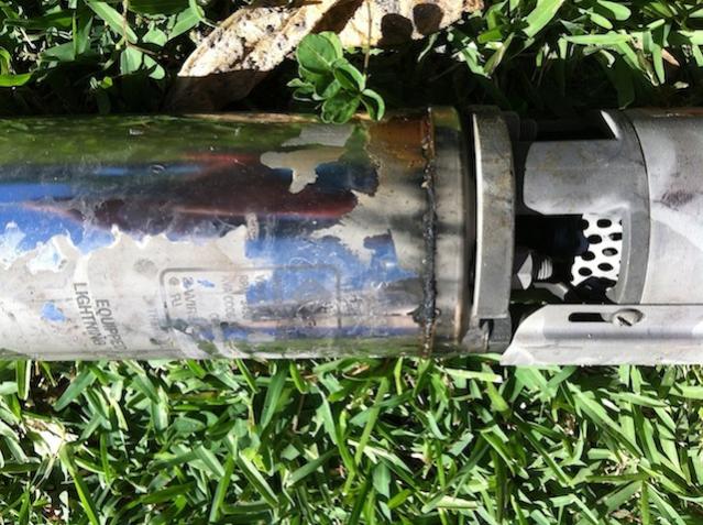

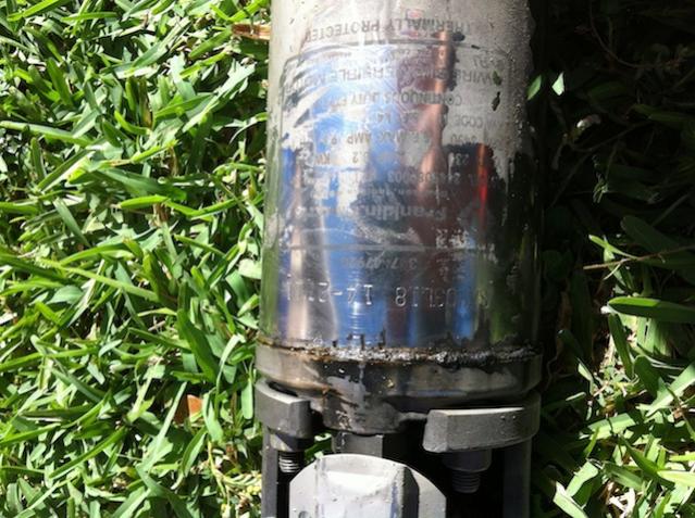

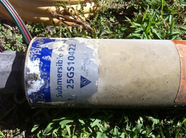

    Here are some photos of the pump.

    To replace the pump, can I replace the motor or does this comes as one unit.
    I would like to add CSV to the system but not sure where it should go and if I need to relocate the sprinkler header after the tank.
  6. #21
    Moderator valveman's Avatar
    Mar 2006
    Lubbock, Texas
    3,475
    Yeah there is probably nothing wrong with the pump end. You can just replace the motor. The CSV just needs to go out by the well, before the pressure relief valve. We have valves that actually fit inside the well casing for just such applications.

    The motor is Franklin Electric 1 HP, 230V, 8.2 Amp, Single Phase, 2 wire. Model 2445089003
