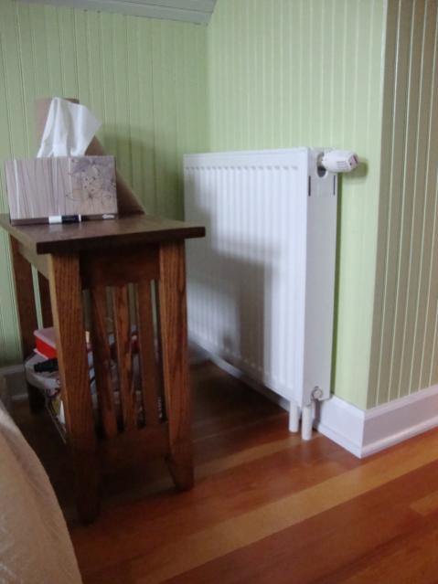

    You don't need Warmboard for a retrofit like yours. I would look for a good deal on European style wall-hung panel radiator properly sized to low temperature applications and controlled for optimum comfort and efficiency.
    PS Yes, the pump that came with the boiler is over-sized, and no, the boiler does not control the pump "speed"...yet.

    You can buy panel radiators online if you know exactly what your going for. PexSupply and others even have free shipping on them to US addresses. I'd assume they would honor an AK order, but the shipping might be slow.
    They're a fraction of the dry-weight of cast iron, but the can be even higher in thermal-mass. Steel & iron have about 1/9 the specific heat of water, so every 100lbs of iron is the same thermal mass as about 11lbs of water, or about 1-1/3 gallons- it doesn't take a lot of water volume in a panel radiator to have the same thermal mass of 20' of cast iron baseboard.
