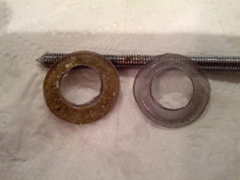

    I have a problem with rust (I think) and other stuff clogging the screen (or is it a filter?) of my KWC shower mixing valves. See attached pictures. For the past 6 years since I installed the valves, I have had to clean them out every 3 months or so because hardly any water came out the shower head. And as of this summer, I have to clean them every 4 weeks. The picture shows one screen the way it looks after just 4 weeks, the other one is clean after I remove the gunk with a tooth brush.
    My question(s): What is that stuff that collects in the screens? The brown stuff is almost slimy. I assume it's rust, but where would it come from? My house is connected to city water. Most of the pipes are copper, except for one bathroom that is unused. Landscape pipes are partially old rusted galvanized, but there is a backflow preventer that stops rusty water from flowing into the house. What is the white and the green chunky stuff? the white stuff feels greasy.

    Is it on both the hot and the cold side?
    If it's only the hot side, then I would factor in the water heater.

    It is both on the cold and hot side. The water heater is a tankless heater that is 8 years old. I recently had that serviced. It has it's own screen, which is much coarser. I did not see any of the brown stuff in there since the screen has bigger holes, but a large clot of the white stuff. The white clot was greasy, almost like soap scum.

    How do you know it is both the hot and cold side? They both flow into the shower head so either one, or both, of them could be the cause of the problem and your symptoms would be EXACTLY the same.

    The mixing valve has a separate screen for both the cold and the hot water pipe before the water goes into the thermostatic mixer. The schematic drawing for the valve is here:
    http://www.kwcamerica.com/doc/techni...ERM_802516.pdf
    On page 2 on the right you can see the place for the two "pre-stopper" units, one for the cold inlet, the second for the hot inlet. They contain the screens that I show on the picture in the initial message. Both of the screens are equally dirty when I take it apart to clean.

    You have an interesting problem, because any sediment in the cold water piping would "precipitate" out of the water in the water heater's tank. If it is originating in the water heater, then there should be none in the cold piping.

    I use a Franke water filter for drinking an cooking water. When I take out the filter element, it is covered with brown slime. These reflect two different things in the water:
    Rust - reddish brown color - ferric oxide - rust originating in steel piping
    Clear slime - proteanacious material from upstream lifeforms - they concentrate at the filter, but are very dilute in the water supply
    Other things you might see:
    Turqoise stuff - copper oxide - natural rust color of copper
    White solid - scale, or calcium carbonate - natural mineral from well water that comes out of solution and grows into solid chunk
    If you understand your plumbing, there may be a way to backflush your shower filter. It requires applying water pressure backwards to the filter, and opening a faucet somewhere nearby so the crud will flow into a sink drain.
    I discovered backflushing many year ago when the bath hot water flow rate was getting very weak compared to the cold flow rate.
    It's due to rust buildup at the bathtub mixer's HW intlet.
    Once a year I backflush the bathtub mixer valve using this method:
    1. Shut off HW supply pressure at the hot water heater tank
    2. Open the HOT sink faucet near the bathtub (no flow since HW supply is off)
    3. Start the bath filling with a medium temp. setting (equal hot and cold) - shower diverter should be OFF!!
    4. Cold rusty water now comes out of the sink faucet....this is the crud that was stuck at the bath/shower mixer.
    5. When the rust clears, you restore HotWater pressure at the heater tank. That's it.
    How does this work? You have to imagine what's going on behind the shower wall. When I start up the bath, the mixer is only getting pressure on the COLD inlet. Because I've opened the Hot Faucet at the sink, I've created a path for cold water to flow there via the bath mixer....cold water flows backwards through the mixer's hot inlet. Backflushing!!!
