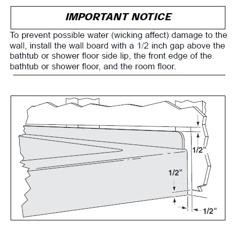

It looks like this subject has been beaten to death on the internet but there doesn't seem to be a consensus, so I thought I'd ask you guys which is better. I'm looking at using Swanstone tub walls with a Kohler tub.

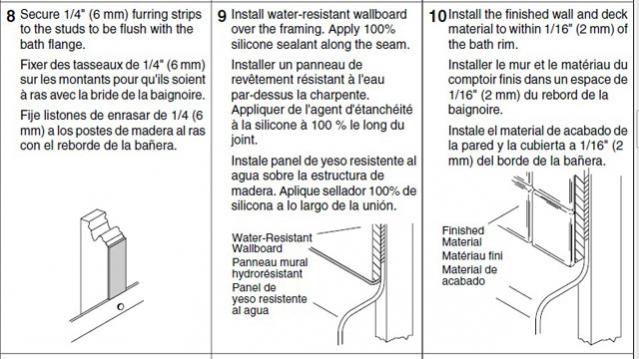

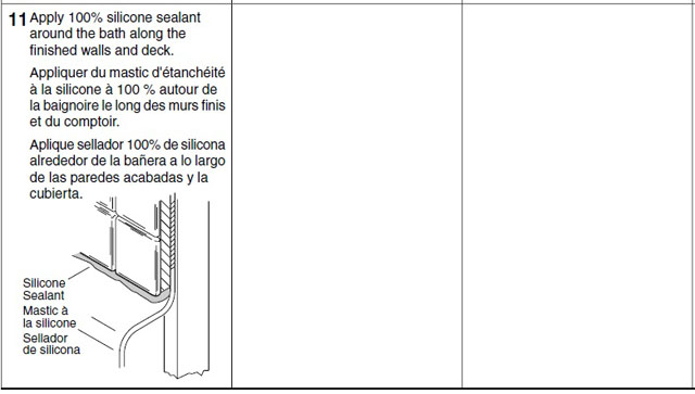

The Kohler tub instructions say to use furring strips to provide a flat surface for the wallboard to overlap the tub flange:
But the Swanstone wall instructions say to stop short of the tub flange:
The second method, leaving a gap, seems the simplest since you wouldn't need a 1/4" thickness transition with the rest of the bathroom walls. Is there any reason to choose one method over the other, or does it not really matter?

Solid panels, I'd consider 1/4" shims and 1/4" Hardibacker. Hardibacker is (I think) the only one the manufacturer recommends as a wallboard in a shower at 1/4". Again, with solid panels, you can probably forget the vapor barrier, as the panels should be totally waterproof.

With fairly rigid surround panels can I get away with furring strips and 1/4" cement board to keep a 1/2" wall thickness, or would it be better to use 1/2" board, leaving a small gap above the tub flange? (the surround panels will come all the way down the 1 1/4" tub nailing flange anyway).
The latter. Use 1/2 inch board and leave a gap above the tub lip.
And, in case you want to know why, it's because one 1/2 inch thick board is more than twice as strong as two 1/4 inch thick board sitting one atop the other. That's cuz the formula for the deflection of a beam has the beam's height CUBED in the denominator. So, for example, a 2X4 being used as a floor joist has a height if 3 1/2 inches. 3 1/2 inches cubed 42.9. A 2X8 being used as a floor joist under the same small floor will have the same width, but is 7 1/2 inches tall, 7 1/2 cubed is 422. 1/42.9 is ten times more than 1/422, so given the same span between supports, a 2X4 floor joist will bend 10 times as much as a 2X8 floor joist under the same weight.
So, 1/2 inch thick board is stronger than two 1/4 inch boards. That's why you can bend a deck of cards in your hands, but not a piece of wood that same size.
And, that's also the reason why a fir 2X12 can be used as a really ridgid floor joist or a really bouncy diving board. It depends entirely on which dimension is cubed.

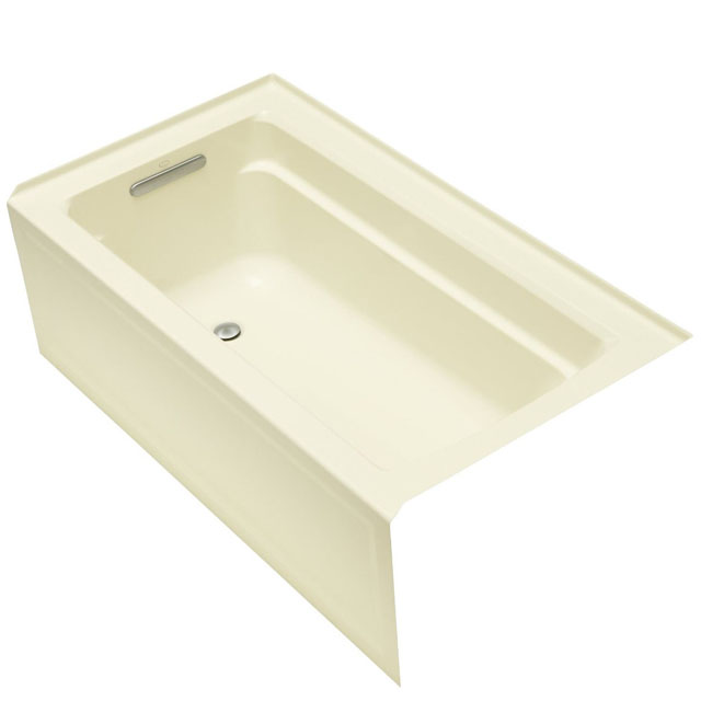

Yes, they are here, although both are unopened and returnable locally at no additional charge.:eek:
The tub is a Kohler Archer 60" alcove in acrylic:
http://www.us.kohler.com/us/Archer-60-x-32-alcove-bath-with-Comfort-Depth-design,-integral-apron-and-left-hand-drain/productDetail/Archer/425546.htm?brandId=429364&skuId=394481&categoryId=429297&hash=id%3Dfilters%26startIndex%3D20%26scrollTop%3D342

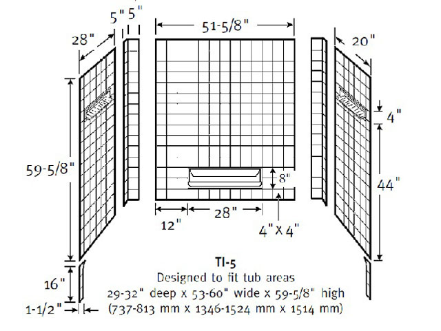

The surround is a Swantile TI-5 in Veritek (whatever plastic flavor that is):
http://www.theswancorp.com/index.php?prod=189
I would have liked to try tiling it but I'm afraid I'd make a mess of that. Thanks again for all the advice.
