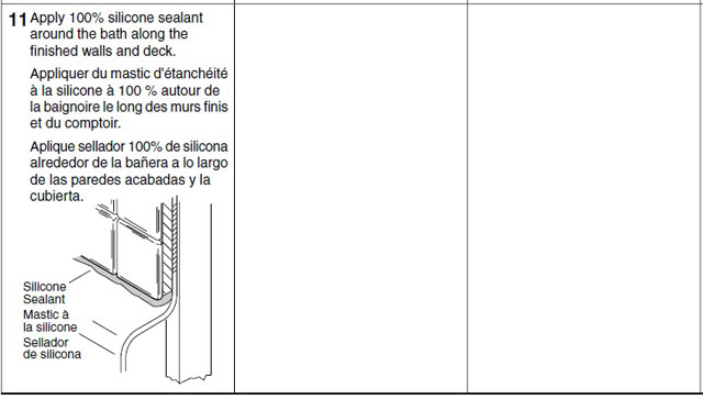

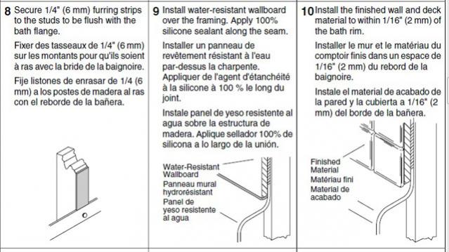

    The Kohler tub instructions say to use furring strips to provide a flat surface for the wallboard to overlap the tub flange:
    Name:  Kohler Tub Install Pic 1_edited-1.jpg
Size:  49.1 KBName:  Kohler Tub Install Pic 2_edited-1.jpg

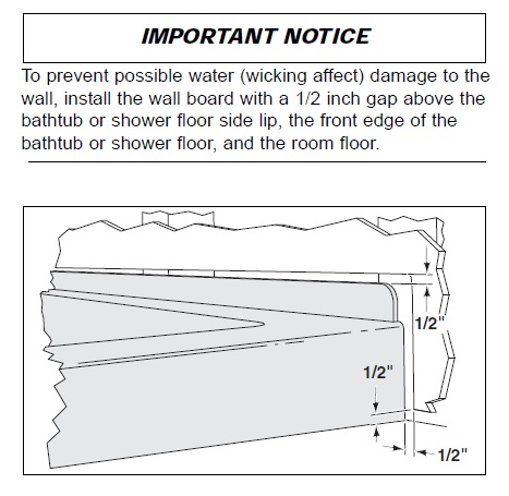

    But the Swanstone wall instructions say to stop short of the tub flange:
    Name:  Swanstone Surround Install Pic.jpg
    The second method, leaving a gap, seems the simplest since you wouldn't need a 1/4" thickness transition with the rest of the bathroom walls. Is there any reason to choose one method over the other, or does it not really matter?

    The top diagram is how the walls should be built to TCNA specifications. That said most times builders and home owners do not like the overlap.
    When you overlap you are forced to use a thinner backer board or build the wall out thicker.

    With fairly rigid surround panels can I get away with furring strips and 1/4" cement board to keep a 1/2" wall thickness, or would it be better to use 1/2" board, leaving a small gap above the tub flange? (the surround panels will come all the way down the 1 1/4" tub nailing flange anyway).
    The latter. Use 1/2 inch board and leave a gap above the tub lip.
    And, in case you want to know why, it's because one 1/2 inch thick board is more than twice as strong as two 1/4 inch thick board sitting one atop the other. That's cuz the formula for the deflection of a beam has the beam's height CUBED in the denominator. So, for example, a 2X4 being used as a floor joist has a height if 3 1/2 inches. 3 1/2 inches cubed 42.9. A 2X8 being used as a floor joist under the same small floor will have the same width, but is 7 1/2 inches tall, 7 1/2 cubed is 422. 1/42.9 is ten times more than 1/422, so given the same span between supports, a 2X4 floor joist will bend 10 times as much as a 2X8 floor joist under the same weight.
    So, 1/2 inch thick board is stronger than two 1/4 inch boards. That's why you can bend a deck of cards in your hands, but not a piece of wood that same size.

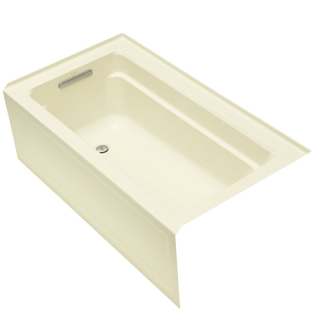

    Can you tell us if you've already purchased the tub and/or the plastic tub surround?
    Also, can you tell us what the tub is made of? (ie. acrylic, cast iron, enameled steel)
    Yes, they are here, although both are unopened and returnable locally at no additional charge.
    The tub is a Kohler Archer 60" alcove in acrylic:
    http://www.us.kohler.com/us/Archer-6...crollTop%3D342

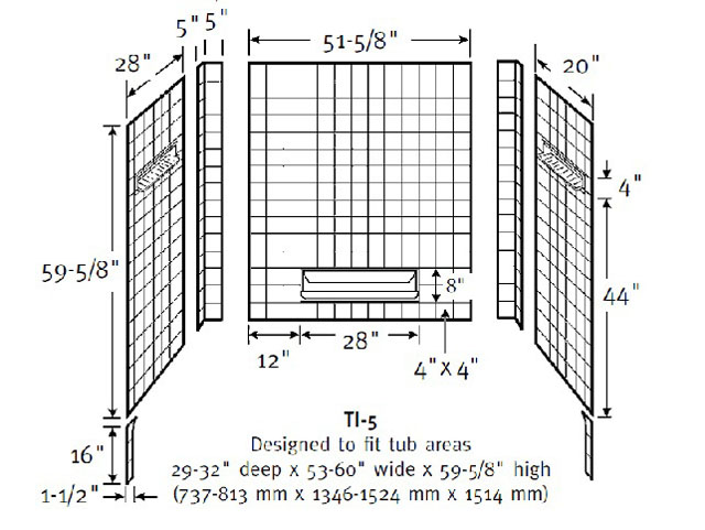

    The surround is a Swantile TI-5 in Veritek (whatever plastic flavor that is):
    http://www.theswancorp.com/index.php?prod=189
    Name:  Swanstone Surround Install Pic2_edited-2.jpg
    I would have liked to try tiling it but I'm afraid I'd make a mess of that. Thanks again for all the advice.
