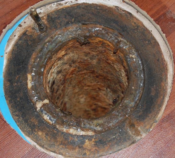

    Hello all
    I have a house built in 1947, and the sanitary lines are all cast iron. In one bathroom, the flange has a broken bolt for the toilet connection. The bolts appear to have been leaded in with the flange. In other words, there is no slot to insert new bolts like I see in most new flanges. Was this a normal practice? If so, where would I get a new bolt to lead in? How was it typically done?
    The flange is in good shape other than the one broken bolt however it is about 3/8" below the current floor due to an remodel. It seems too bad to replace it just because of the bolt, but I could do that. If I did, I see two types of replacement flanges. One seals on the inside of the pipe, and one on the outside. It seems like the type that seal on the outside would be better in this case because the inside of the pipe is pretty rough. I could lead in a new flange as well if I could find one, but it seems like replacing the bolt is the best bet if I can figure out how it is done.
    Thoughts?
    Thanks
    Dave
    Tucson, Az

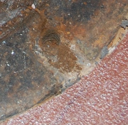

    I am guessing that this one has the single slots on the side, and they are full of lead. The bolt that broke was definitely not a closet bolt that slips into a slot. Maybe I can remove the lead and use a closet bolt but the slots look a little wide. I could use a washer I guess. I attached a photo of the flange, the point where the broken bolt was, and a picture of what I think the broken bolt may have been. It looked like it was leaded in at some point. Also, the repair rings I have seen don't seem like they would attach well to a flange with just the two closet bolts. There are no other holes or slots in the flange.
    Thanks again for your help.
    Dave

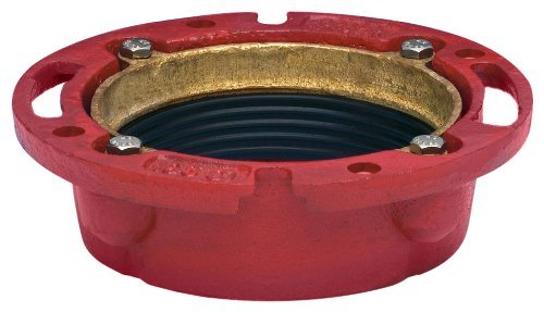

    You make a good point. I am guessing that lead connections and joints are not commonly installed anymore even on repairs by plumbers. That's why my original post alluded to repair flanges that seal on the outside like this one from Oatley
    It may not be clear in the picture, but the original flange is in good shape although it is below the finished floor. If I can get the replacement toilet bolt installed properly I can probably save it.
    Thanks
    Dave
