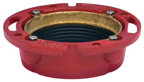

    You make a good point. I am guessing that lead connections and joints are not commonly installed anymore even on repairs by plumbers. That's why my original post alluded to repair flanges that seal on the outside like this one from Oatley
    It may not be clear in the picture, but the original flange is in good shape although it is below the finished floor. If I can get the replacement toilet bolt installed properly I can probably save it.
