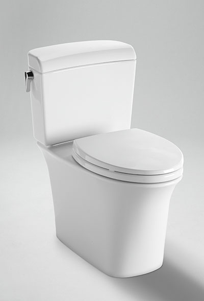

    Hi,
    Has anyone seen or tried the new Maris toilet?
    I was planning to get the Aquia One-Piece but saw some reviews complaining that its flush does not remove all residues due to its small water hole and manual cleaning is required very often. So I was going to go for Legato instead, but now there is Maris. Just wonder if Maris will do better than Aquia performance wise since it uses Dual-Max Cyclone and has SanaGloss despite its small water hole?

    Glancing over the specs, it appears to be a very worthy addition to the Toto line. Nice, clean lines and the skirt makes this a very good looking toilet. I wouldn't hesitate to buy it. One thing you can be sure of is this is a quality product. Toto does not produce anything but high quality.

    Pros: It's a dual-flush, but instead of a washdown flush, it's a double-cyclone. The first to blend the two. Cool!
    Cons: Brand-new flush-valve, handle-actuated by pulling chains from pushing or pulling handle. PARTS LIST I would love to see more than a sketch of that thing and develop some confidence that it's going to last, as opposed to being like the first batch of Voreto Chinese fill valves. Also the latest Voreto fill valve used in this toilet looks more and more like a 400A (TSU42A, but maybe that's just the sketch). No reason yet to think it can't be replaced by the adjustable Korky, however. I will be very interested to see a video of this toilet operating, as soon as someone has it installed and working.
    A few other things stand out: although a skirted toilet, no unifit adapter; now using wing nuts on the tank-to-bowl set; servicing instructions for flush valve look a bit complicated. But we'll see once it's in and working for folks.

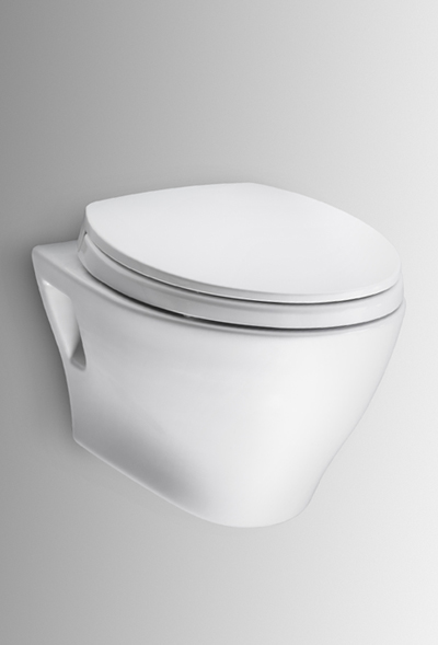

    Hey, would like to revive this thread. Is there anymore information or input on the Toto Maris. Literally about to order the wall mounted Aquia and just found out about the Maris. Can't find any reviews about it. I'm going with the Geberit Wall Carrier, so flushing mechanisms and parts are not my main concern. Just want to know how it compares with the Aquia and if it's available. Was about to order the Aquia from Love Plumbing today. Just one now to make sure we like it and 5 more for the bed & breakfast later.The "Home Improvement" shows are always installing these wall mount toilets but I can never find any substantial reviews about them. So, any current information about the Aquia and Maris would sure be appreciated.

    Take a look at the spec sheets from the Toto web site. MARIS SPECS AQUIA SPECS
    The Maris wall-hung and Aquia wall-hung are both washdown flushes. (The Maris floor-mount model uses a Double-Cyclone, but that wouldn't work on a wall-mount because it has to work with a wall tank.) The Maris is a little different looking, and is an inch longer. They both have the same trap size and water consumption. The Aquia water spot is a little bigger. Given that they use a standard carrier, they are going to mount pretty much the same.
    I think it's going to boil down to aesthetics. Maybe an advantage to the Maris sitting position being a little further forward off the wall, although the spec sheet isn't 100 percent clear on that; i.e. where the extra inch comes from.
    We have the Aquia wall-hung at my club's beach house, with Toto carriers. Looks nice and works reliably. I assume the same will be true for the Maris.

    Appreciate the response. I agree that the specs are very similar. That made me wonder if I was missing something. Why 2 products with such similarity? The slightly rounded tank of the Maris will be non existent with a wall carrier. And couldn't really see much difference in the bowl design and looks. Ordering the package through Love Plumbing since they are considerably less expensive than out local parts houses up here. Thanks again.
    14,195
    I checked the Geberit web page, and their carrier uses the 320 dual-flush tank, which is listed as working with the Bolero Actuator Plate from Geberit.
    And of course the CT418FG Aquia bowl works with the carrier.
    CT418FG Aquia
    Maris CT486FG wall-hung bowl

    Actually, given that there is a limit to how "different" a bowl can look when it's hanging off the wall, I think that these two do have different looks. Take a look at the photos in the spec sheets. As a practical matter, I think that the Maris might be a little more comfortable given that the seat bolts (and thus the whole sitting position) seem to be about an inch further off the wall than the Aquia. OTOH, if you are trying to minimize instrusion into the room, maybe that absence of an inch of china on the Aquia makes a difference.
