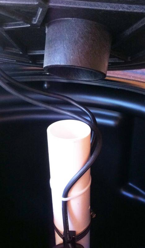

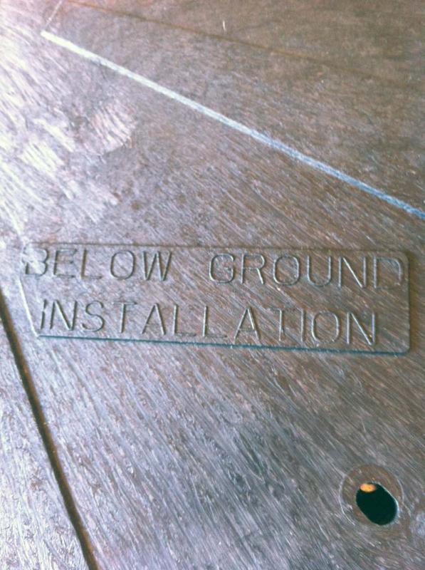

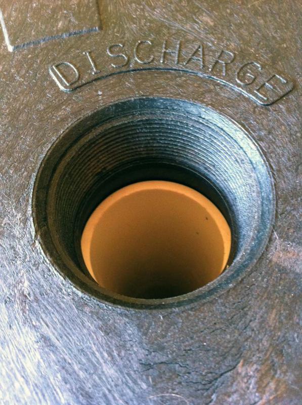

    While taking some pics to post, I saw something on the lid. The underside of the lid shows the poly sleeve that looks as though it is intended as a coupling. No rubber grommets in sight. The top of the lid shows the threaded connection with the 2" PVC below that slides into it. Then there is the message that may or may not be important. Can this be installed in a basement, flush with the rest of the floor?

    23,518
    quote; Can this be installed in a basement, flush with the rest of the floor?
    That is what "below ground installation" means.
    DIY Member DVMSteve's Avatar
    Jan 2006
    Jones County, NC
    44
    OK, well, I thought it might mean that it is intended to be entirely buried in the dirt, like in an outside installation.
    Still, what about the lid and connection to the discharge pipe? Will this work, or do I need to return what I have to the supplier and have them order something different, like the one somebody inserted a picture of above?

    And the answer is: my supply guy called Zoeller while I was there. There was a missing hardware bag that was supposed to be there when the unit shipped. I didn't know to look for it. They're mailing it to me, and it will have the required gaskets and seals.
