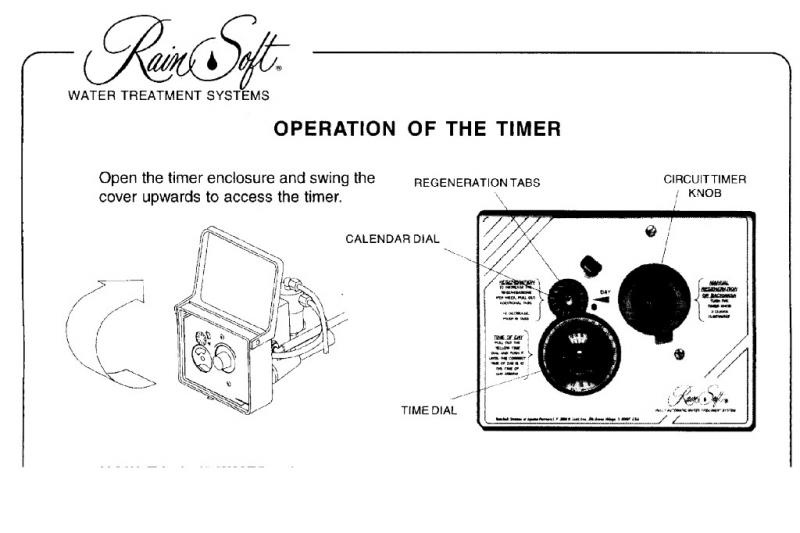

    Sorry I'm very new at this. Gary, I appreciated your quick reply. This is the first I've been able to get back to the water softener. I'm not sure if I'm sending this directly to Gary or posting it to the board. I've blown out the two smallest lines leading to the top of the ball housing and made sure their connections were tight. I saw no type of screen. On this model where is and how do I get to the injector to see if it, the throat, or the screen is blocked?

    Many of the RS models used proprietary threads so as to not allow their valve to be replaced with a standardized design. If you are unable to get the valve working, you will likely be replacing the whole unit. Post the best pictures you can, most of their valves were based on common valves, a couple of pictures and we can probably give you a little more guidance.
    I just found this old manual, is this the unit you have? Sorry about the picture quality. If you do have this, I would recommend it is time to update to a modern water softener. Name:  744.jpg

    Again, thank you all for taking the time to read this and comment. Yes, Dittohead, that is exactly what I have. In the first illistration on the left the ball valve in the back - - those two small lines running to the top of it are the ones I've blown out.

    I am fairly certain this valve has been discontinued, but check around, dont take my word for it. I would recommend a modern, efficient softener to replace that unit.
    Are you sure it is only 12 years old? When I was working the field regularly, that system had already been replaced for some time. This is a time clock system, not even legal in many states anymore due to their inefficiency.
    Wish I had better news, maybe someone else on this site will have more insite now that we know which valve it is.
    6,790
    That looks like the original RS brass valve, you won't get parts for it because it was discontinued many years ago. Today they use a modified Fleck 5600 (IIRC) valve.
    I used to have a supplier for a tank adapter to convert RS's smaller diameter and fine thread green tanks to standard 2.5" by 8thrd/inch but don't know if there are any today.
    So it's time for a new correctly sized softener...
    Plus your softener is a smallish 1/2 cuft (7" x 44" tank) and way too small for a once per week regeneration.
