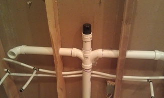

So I had someone finish some plumbing for me since I have been too busy to mess with it.
He finished yesterday and I had time to go review the work today. Correct me if I am wrong but unless something changed recently...Terminating the vent pipe in the crawl space is no bueno right? :mad:
Also, would using an AAV off a dual sink and putting it in the wall cavity also be incorrect?

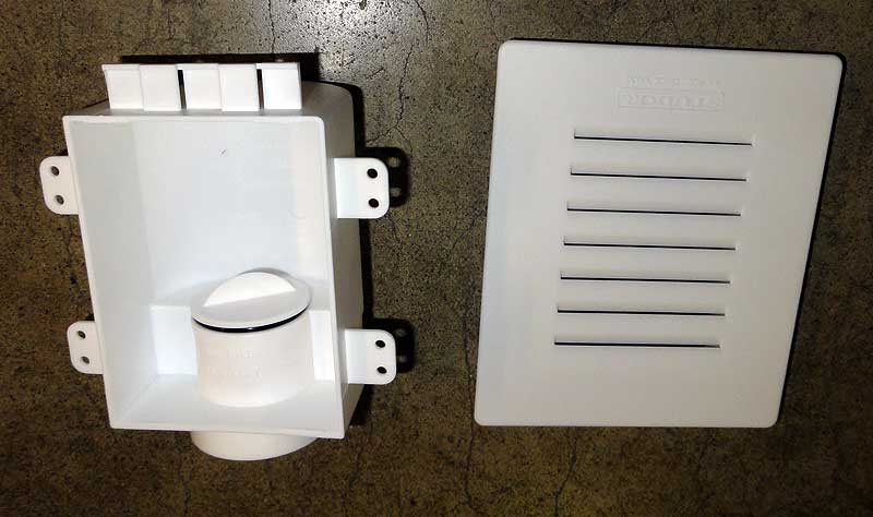

The AAV only works if it's accessible and ventilated.
They make boxes with grills for that purpose.
Also, two lavs should be run with 2" pipe, and then the individual trap arms and the vent can be 1.5"

Running the pipe to the attic and using the AAV up there would be acceptable though right? Also, did you agree with the vent pipe terminating in the crawl space in picture #1 being COMPLETELY wrong?
3,461
That seemed so crazy I didn't think to respond.
No vents should terminate in a crawl space. Vents should go through the roof.
If the AAV in the attic can be accessed, that would be okay. A vent lets out gas though, so a "vent" would extend through the roof. I used to install five or six vents through a roof a day. It's not that hard.

Well the sad part is that there is already a vent exiting the roof above the area where he just left it in the crawl space. He said that he just capped the vent on the top of the roof and didn't need it because of the way he ran the plumbing. Unfortunately that was on Monday and I have been working and just now got time to go look at everything.
Quite sad that someone who calls themselves a plumber could be such an idiot.

That vent in the crawlspace can't be a vent either because it's horizontal

I am not sure which line is the terminated vent, but it is almost impossible for a line under the floor to be called a "vent" in the first place, especially if there are no traps under the floor for it to "vent". He must also have been in too much of a rush to "anchor" the water stubs through the wall. OR maybe he doesn't know how to do that either.
