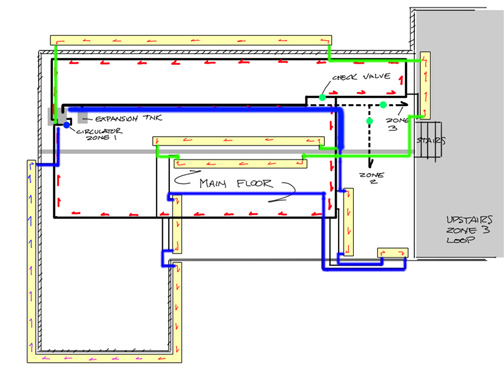

    Water will always flow to the path of least resistance. Running too much baseboard off a monoflow tee does not work because the resistance through the loop is greater than the resistance through the main. If you have the money the best thing to do is to pull the main monoflow feed and return altogether and run individual pipes ( I like 5/8" heat pex ) to each convector or radiator and then bring them back to manifolds at the boiler. A single circulator can be used with balancing valves or a single circ with thermostatic valves at the radiators. The baseboard loops get brought back to their own circulators and their own thermostats or they can be grouped as separate loops with theri own thermostat(s)
  2. #17
    Tom, that is what I am hoping would work. I've revised the drawing from earlier and wonder if this might not work out. I think if I were to break up the two main loops differently as shown I can get a closer to even flow restriction on both sides of the loop thereby limiting issues with the circulator drawing more from one side than the other.
    thin green and blue line represent your recommended 5/8 pex creating new series loop and thick blue line is main supply feed coming off boiler.

  8. #23
    Well, it was a long weekend but my monoflo system is no more. Lot's of planning for rerouting lines to balance the system. Ended up going with the same 3/4" copper instead of Pex. My skinny fore arms are sore from all the cleaning of fittings and pipe. In between fingers I've got a nice little rash from the flux. (not to mention I can't seem to get all the black out of my hands.) I was using gloves for the most part....
    Glad to say the heat now works on both sides of the house. It's awesome to get "real" heat coming out of those last baseboards at the end of the one 60' loop that never got hot before.
    Only bummer was Sunday morning realizing that my pressure/temp gauge on my boiler wasn't working (no change in pressure readings). I seem to recall now the last time it was serviced the guy telling me that. Would have been good to have one on hand to replace while the system was down.
    Thanks for all the input. Now on to trying to get more insulation in the house....
