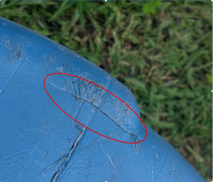

    I have a conventional non-proprietary softener and noticed the same problem a couple months ago. It was easy to identify the 11-year-old brine tank as the source of the leak due to the location of all my components, but the taste test and the white salty residue at the margins of the spill area (where the water had evaporated, leaving the salt) confirmed it. I removed the "dry" salt from the tank for reuse, dumped the remainder into old salt bags for disposal, and flushed the area thoroughly to get rid of the salt. On inspection of the failed tank, I found it had cracked on the bottom for no good reason -- I'll post a picture later.
    Later:
    Name:  Crack in brine barrel.jpg
    (I kept the old tank for use as a lawn-trash barrel.) No idea why it decided to crack after sitting in the same place for 11 years, but it was a low-quality concrete job on the floor, and there may well have been a piece of gravel or somethingunder the barrel. A trip to a local dealer and $100 later, I had a new tank and tower -- all I needed was the tank, but all he sold was the combo. 15 minutes to install, refill with salt, and start a dummy regeneration cycle and I was back in business.

    I have a conventional non-proprietary softener and noticed the same problem a couple months ago. It was easy to identify the 11-year-old brine tank as the source of the leak due to the location of all my components, but the taste test and the white salty residue at the margins of the spill area (where the water had evaporated, leaving the salt) confirmed it. I removed the "dry" salt from the tank for reuse, dumped the remainder into old salt bags for disposal, and flushed the area thoroughly to get rid of the salt. On inspection of the failed tank, I found it had cracked on the bottom for no good reason -- I'll post a picture later. (I kept the old tank for use as a lawn-trash barrel.) A trip to a local dealer and $100 later, I had a new tank and tower -- all I needed was the tank, but all he sold was the combo. 15 minutes to install, refill with salt, and start a dummy regeneration cycle and I was back in business.
    This sounds and looks exactly like what Im experiencing....there is a great deal of salt on the floor in the water, which led me to believe it was the brine tank. Ill confirm by continuing to dry the area until I can see exactly where its coming from.
    Thanks very much!
