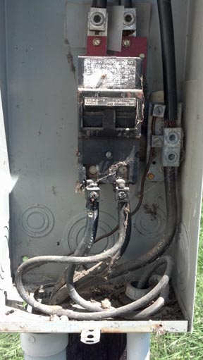

    ok, so Im planning on putting in a new a new 200a panel with a few spaces on the downstream side of the existing service disconnect.
    I'll run appropriate size copper to this new panel mounted w/in a few feet of the existing pole. I'll have a 100a breaker to service the cabin (there is already 2/0 copper to the cabin from the existing service disconnect, I'll reroute). I'll have an 85a breaker for service to barn and I'll reroute the existing #4.
    My next question is on grounding and bonding.
    In the existing service disconnect, the neutral and ground are connected (though I don't see a bonding screw) and I'm assuming neutral is bonded by the fact the ground/neutral strap are one and the same,:
    So, assuming the 1st service diconnect is bonded, I should ensure this new panel Im putting is unbonded as well as any downstream subpanels, correct?

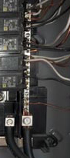

    If so, I notice another problem w/ existing service in cabin, the subpanel in cabin appears to be bonded as the box doesn't have separate straps for ground and neutrals:

    Neutral and ground are only to be bonded at the first panel...all down-stream ones they should be separate. Each building needs its own grounding rods (min of 2). As to how best to do this, I'll defer to the pros...

    You need a ground rod at the barn. It will tie to an Equipment Ground Buss that is installed by you. Instructions will come with the panel. Neutrals go where you would expect to see them.
