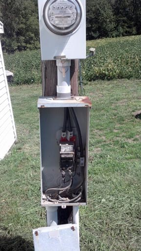

    Here you see the meter head and a 'sub panel on the pole outside of cabin. the breaker in this panel is 200a

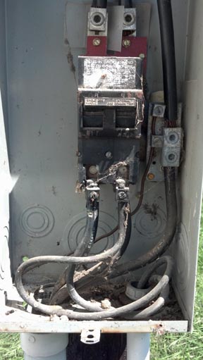

    A close up shows two conductors and a neutral out one knockout and two conductors (but no neutral) out another knockout(right side)

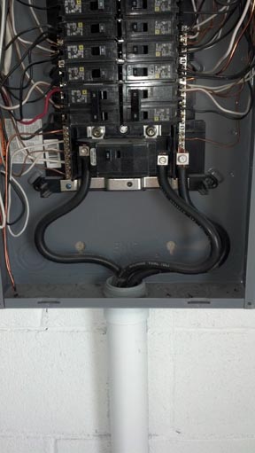

    On the indoor main panel of the cabin, things appear ok, two conductors and a neutral on 100a main breaker:

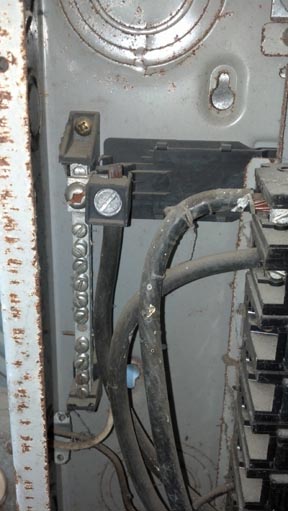

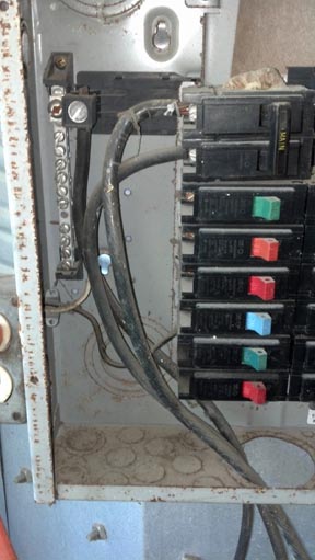

    Now, out in the barn, which is approx 100f from the pole with meter head and 'sub panel' (first pic) things aren;t so great:
    This is a 100a main with two conductors and a neutral, though the quality of workmanship and materials leaves much to be desired. The two conductors do indeed originate from the 'sub panel' under meter head on pole near cabin. The two conductors are trenched and run through pvc conduit:
    Note the two conductors in conduit, and the #4 on the left is the neutral in the panel in pic above. The problem, this neutral does not originate from the 'sub panel' below the meter head, nor does it originate from the main panel inside the cabin! I really don't know where the neutral is coming from, but perhaps it's tied to a ground rod somewhere.?.

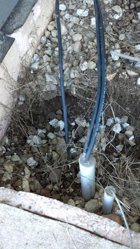

    -Are the two #4 conductors ran in conduit from 'sub panel' on pole sufficient for the new 100a panel I plan on puttting in the barn.
    - Should I pull a new #4 neutral (or smaller?) from sub panel on pole to my new box in the barn?
    - Should I put a ground rod at barn and ground panel in the barn?

    There are several issues with your set up, enough to cause a repair order from the inspection department or lose power.
    First the panel under the meter is not a sub panel it is the service disconnect. The service disconnect (the 200 amp breaker) is double lugged and the conductors are not sized to 200 amps. A #4 copper is only good for 85 amps and can have a 90 amp max breaker.
    The RDP (remote distribution panel or sub panel as most will call it) on the inside of the cabin requires a disconnect to open all ungrounded (hot) conductors at the same time or a main for that panel.
    The feeders at for the barn defies all explanations known to anyone in the electrical trade. Even if not needed a neutral must be installed with the other conductors and a grounding electrode system installed for this panel.
    On a side note; as an electrical inspector when I came to do the inspection I would require the entire electrical system to conform to the code in effect at the time of the last permit. If there was no record of a permit being issued then the entire system would be required to conform to the code in effect at the time of my inspection.

    There is a neutral wire in the panel in the barn(call it rdp or subpanel). It's a #4 copper. Problem is I cant tell where it originates from. Its not in the panel from inside the cabin, nor is it from the service disconnect box. I have no idea where that neutral comes from.
    There is a ground rod at the pole and the meter base and the service disconnect seem to properly attached. I dug down and found the ground electrode.
    It seems I have 3 urgent items to address: 1) neutral in the barn, 2) lack of ground electrode in the barn and 3) undersized conductors from the 200a breaker in service disconnect. I will be picking up a new square d panel w/ 100a main and several breakers tomorrow.

    In order for this set up to be compliant with today’s codes you will need to do several things.
    The service disconnect on the pole will need to have two breakers, one for the cabin and another for the barn or the barn will need to be fed from the cabin.
    I would use either #4 copper or #2 aluminum and protect it with a 90 amp breaker. I would also use four conductors, two hot, one neutral and one equipment grounding conductor #8 copper or #6 aluminum.
    The cabin will also need to have a main breaker in its panel or a disconnect installed that opens all hot conductors and it also will need four conductors, two hot, one neutral, and one EGC. Two 4/0, one 2/0, and a #4 aluminum or two 3/0, one 1/0, and one #6 copper.
    The main breakers in both the barn and cabin will need to have a retaining clip of some kind to prevent it from being pulled out while on. Each RDP will need to have a grounding electrode installed. The neutral of both panels at the barn and cabin will need to be isolated from the panel and the EGC. The grounding electrodes bonded to the same terminal bar as the EGC.
    If you contact the building inspection department and ask for advice I am sure they will help you in any way they can. It is possible that they will allow some of what is there to remain and not be changed but if they do keep your records.
