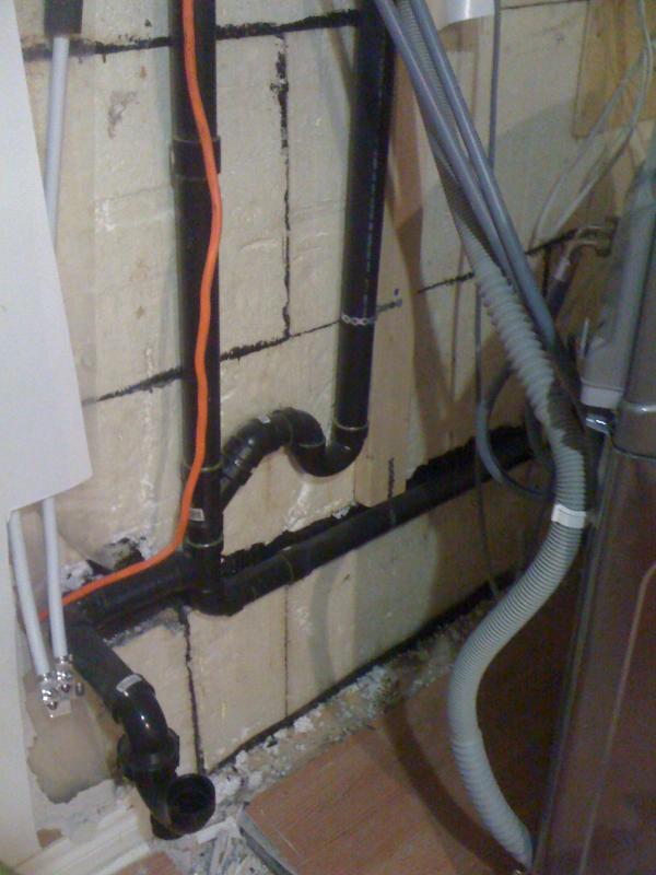

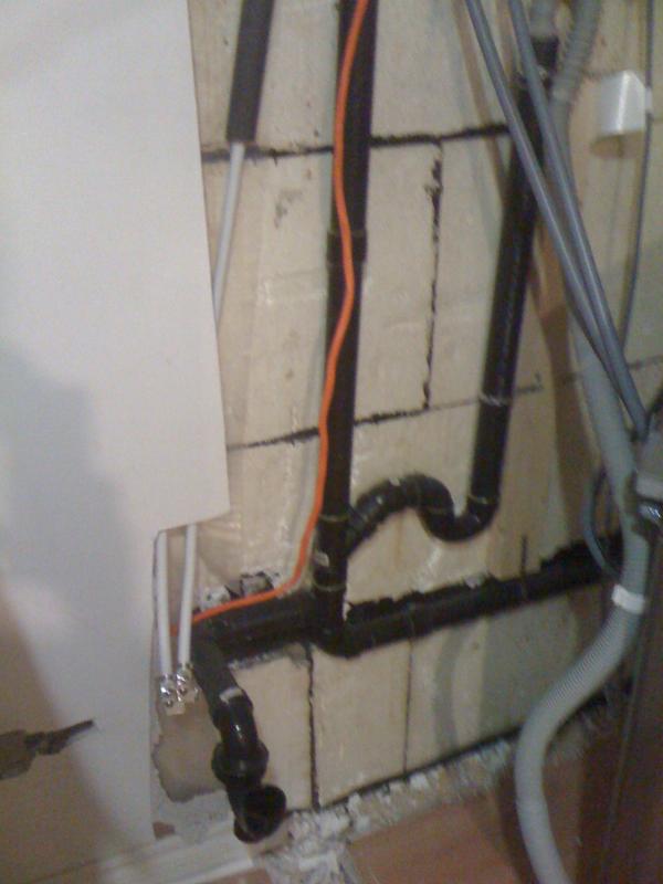

    Ok so here is the story, the wife wanted a sink next to the washer.
    So i did a rough-in and she ran the washer and once i got a little water backup (about 1 cup) into the sink drain.
    Is this done correctly or what would you guys change?
    I know it should be a 2'' abs tube but its a 1 1/2'' and everything was fine till i added sink.
    I am thinking its because the drain for the sink is below the washer , but the reason i did it that way is cause if not the drain would be too high (18'' +) for the sink.
    Any ideas ?
    BTW where you see the orange wire it leads to a AAV and main drain is coming from the right side.

    If the connection to the sink was a wye rather than a sanitary T, it might work better. Or, maybe a double-wye to keep the overall length down. Wait for a pro to comment, as I probably am missing something...

    You see my main problem is that i need to keep the height down.
    If i put the sink above washer it will be too high. How can i have both on the main branch without raising sink level.

    Instead of trying to wet vent a washer over a sink, (which would never be allowed in any plumbing code, even if it had been run in 2")
    Cut in a wye for the washer to the right, go up to a "Santee" for the trap arm.
    For the sink, continue on from the wye horizontal and use a combo fitting for the vent on the trap arm. Now the two vents, the washer vent and the sink vent can tie together at 42" above the floor.
    Running a washer past a sink drain is a problem.
    Wet venting can only be done on bathroom groups.
    Wet venting requires 2" or larger piping.
    A wye fitting on the vertical on a trap arm, is an "S" vent. It will siphon the trap. A Santee should be on the vertical for a traparm.

    Just 1 question, when you say the washer and sink vent can tie together do you mean i use only 1 vent (AAV) or tie together with no vent or double vent ?
    Thanks !
    Matt
    14,202
    A vent is always required.
    You can tie vents together and use one AAV as long as you have an atmospheric vent somewhere on the system.
