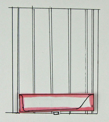

    WAAAAAAY too difficult. You are a glutton for punishment and a candidate for a bad back. It is also usually not possible to remove the drywall from the opposite side for a remodel/replacement installation. I use the "Egyptian pyramid" method, which employs as little effort as possible along with the maximum use of leverage.

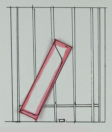

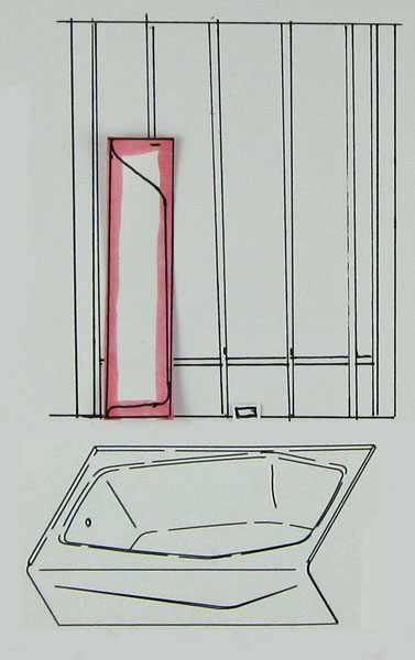

    ON some tubs a 2x4 ledger is too thick and it hits the radius of the tub. For those, or if you are not sure, use a 1x4. As for getting it into the space. Lay the tub on the floor with the apron on the bottom. Get it into the approximate position. Remove the front, top, and back of the crate. Place "something" on the floor, (cardboard, or 1x2 strips, or anything similar to protect the tub edge), and slide the tub off the crate onto it.Then, depending on how large the recess is, either roll the tub down and onto the ledger, or angle it in between the studs on one end, then turn the tub parallel to the back wall and roll it down into position. When the tub drain is installed depends on your space. If you have access after the tub is in position, put it together last. Otherwise, assemble it on the tub, remove the assembly and put it into position while connecting it to the drain, then put the tub in place over it.

    Actually, it is almost easier to do it than to describe HOW to do it. IF the tub is going into a recess with a knee wall or other way that the tub can fit in front of the opening, then you START with the tub in the location of Terry's second posting, (otherwise you get the tub as close to the final location as possible, usually at an angle), but with the tub laying on the apron in the crate. You remove the crate except for the bottom piece the tub is on. Then you slide the tub out of the crate onto a couple of boards, 2x4's are best because they are the same thickness as the bottom plate of the wall. Then you toss the last piece of the crate away to get rid of it. If the tub is on an angle, you slide it forward so the upper edge goes into the space between studs. Then you rotate it square with the back wall. At this time your tub is at the recess, between the two walls. Then you gradually rotate it downward onto the ledger board. If you have it is the right position to start with the tub will hit the rear studs before reaching the ledger. Then you can let go of it and get your hands out of the way. The tub will continue down by itself, or you can push it if necessary. Now all you have to do is jack the front up a bit and remove the two boards. With a two wheel hand cart to move the tub into the room it is a one man job. In fact two men might get in each other's way.
