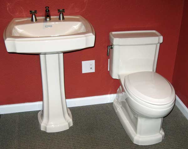

    I love my Carlyle BUT that was not the one i wanted, my wife did not want to spend the extra money for MY favorite.
    Name:  Toto Guinevere Pedestal Lav & Toilet Suite.jpg
