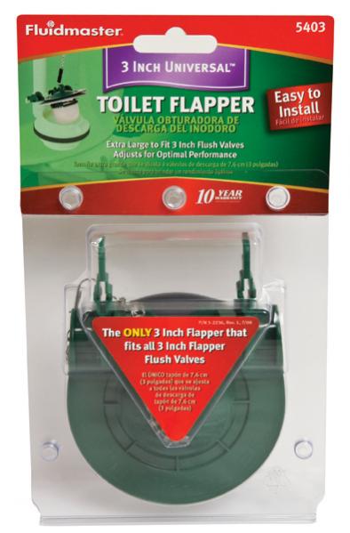

    Default Finally, closure (literally & figuratively)
    Here's what solved the running toilet problem. It has this adjustable float body that I don't quite understand. If anyone who is familiar with these would care to explain that, that would be great!
  4. #109
    19,226
    The factory flapper valve is calibrated to close after the designated amount of water runs down the drain. Keep in mind that each toilet is a little different. The water used to flush consists of both that in the tank, and what's in the bowl. So, you need a means on a generic replacement to calibrate how much water gets dumped before the flapper drops down to close it off won't be at the same tank level (since each bowl gets refilled separately). Essentially none of the new toilets empty the tank when you flush. the adjustable part lets you make it close faster or slower. Now, getting it set to close at the manufacturer's specified level may take some trial and error. Too quick, lousy flush. Too slow, waste a bunch of water each time.
