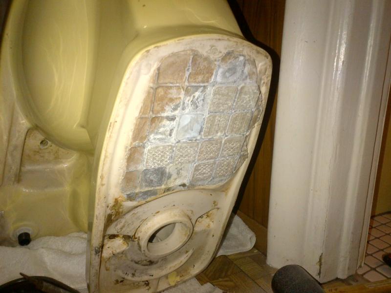

Tried to remove my Mom's toilet to check the wax ring, etc as it was leaking at the floor rear with every flush. I did a couple in my time but this one wouldn't budge. Learned the person who installed it set it in Plaster of Paris. Tried some medium pushes, pulls, shocks with the palm of my hand, and using a mini carbide hand saw around the perimeter but that went nowhere slowly. Someone told me a good swift kick usually works for him but I'm reluctant as it's a medium priced one piece unit. Any suggestions? How much of a shock can a toilet take?

Give it a good shot with the palm of your hand.

I did but will try again.. Any particular spot better than others for taking a shock? At the base? The rim? It's a American Standard one piece elongated unit if that makes a difference.

A good kick on the outside of the rim usually frees it, UNLESS it is set into the tile with grout around it. THen you have to cut the grout out first. In 60+ years, I have set a lot of toilets with plumber's putty, but have NEVER used Plaster of Paris or buckets of wax.

Maybe not in Arizona but in New England it was very common. Most were on lead bends and some without flanges.

I guess I got lucky. Yesterday gave it 2 or 3 rather hard smacks with both hands against the rim and it broke free with the toilet in one piece. Took some tiles with it. Better than leaving part of the toilet on the floor! I really don't know if that was Plaster of Paris or something else. Really hard stuff! A little tan in color. I thought plaster was white? Replaced some tiles that came loose around the perimeter on the floor but leaving those that are not coming out of the toilet where they are. Don't want to risk cracking it with any more chisseling. As long as the perimeter is solid and the concrete or cement floor underneath is too, I imagine it'll be ok to set them back in the void they were lifted from. Just chiselled the ridges down so there is a little space. Will use shims and a little caulk when putting it back down. BTW, it seems it was just at the wax ring that it failed. Surprising the old lead bend and brass flange seem solid. Did a couple of test pours with buckets of water as a test. Didn't replace it yet. Let the tile set - then some grout. Thanks again.

I'd say you were lucky. That's not plaster of paris. If it was they wouldn't have used a wax seal. It looks more like grout to me. I don't think I would try to remove the remains of what ever it is on the bowl.
