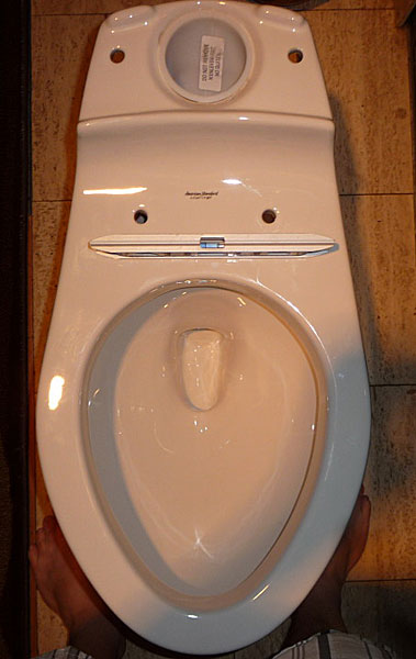

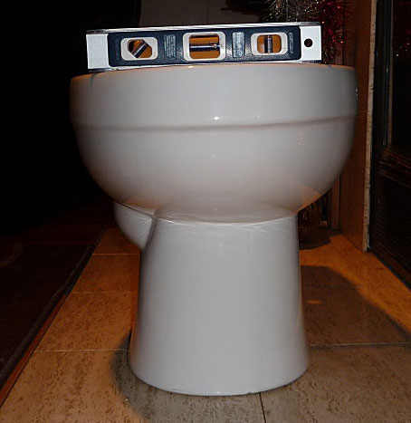

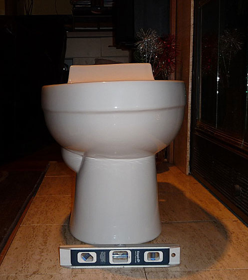

    Well, I can finally add to this list of complaints with the Champion 4 toilet. I had to see it for myself first hand what's so awful about these toilets and so off to do the unthinkable and buy one I did. Ordered it from a local plumbing supply house picked it up 3 weeks later, got it home took the bowl out of the box and found the bowl with a terrible defect...it leaned over severely to the left. For whatever reason that possessed me I still installed the thing and then realized it looked even worse in it's location then when I got it out of the box.
    Ended up driving me crazy and I ripped it out a day later and traded it for a Cadet 3 at the supply house, which for your money is a FAR better value over this so called "Champion", the difference between the Cadet 3 and Champion 4 is almost unbelievable.
    What kind of company makes there cheaper toilet the better one. (I knew this all along but wanted to try the Champion out anyway)
    for 250 dollars the Drake sure is the best bang for your buck (I knew this all along too, but wanted to see first hand how awful the "competitor" really was), that and I was getting bored of the perfect no maintenance impeccable quality of the two Drakes in our house.
    Anyway, I've got some pictures here to show just how bad this thing leaned over, and the porcelain wasn't that great of quality either...

    Now would you expect a professional plumber to install a bowl that was leaning like that in your home?
    How much time do you suppose you wasted going back and exchanging the bowl. I don't know what you do for a living, but can you imagine telling your boss that you just wasted four hours exchanging something, so the entire morning was lost? How much money can a plumber bill for in four hours? And all of this because nobody is checking the products before they are being shipped out?
    And you wonder why plumbers are pleading with their customers to buy something pre-inspected at the factory. I sell all the brands, including Kohler and American Standard, Gerber and Caroma, but of all of them, you should have stuck with Toto.
    Thanks for the pictures and the story. Now you know we aren't making this stuff up. It happens.

    That would be just perfect if you have a sloping floor! Provided the floor slopes the right way...Maybe they make these in "rights" and "lefts"?
    All kidding aside, that's unbelievably bad. I've had great luck with my Champion 4 but after seeing that, I don't know that I'd buy another one.
