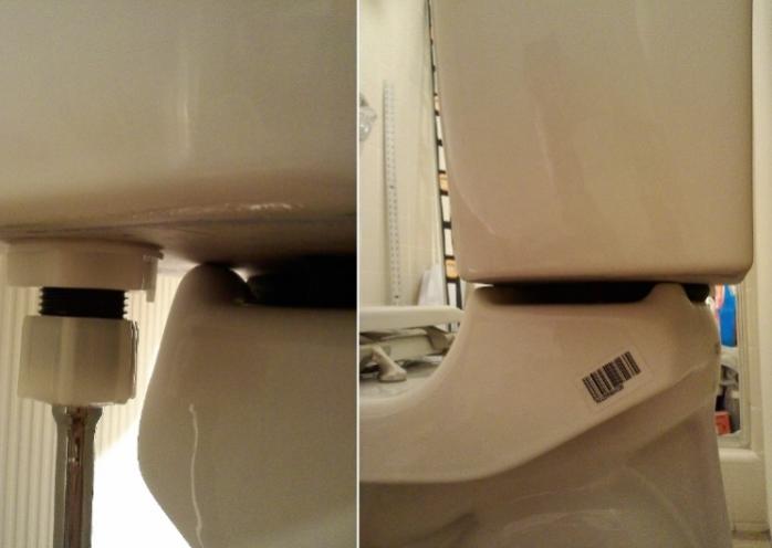

    As far as looks, it is way better than the Toto Drakes I had installed in my previous home. They were too small in my opinion and looked like something you might install in a child's bathroom. The tank looked so dinky against the wall and set away from the wall about 3-4 inches. This basically negated any advantage you might think you get with a smaller footprint because the edge of the bowl was still about the same distance from the wall as a "normal" size toilet like the Champion 4. The Champion 4 has a nice, full size tank that fits right up next to the wall with a 12" rough-in.
    I hope 3-4" away from the wall is an exaggeration.
    Not sure which Drake you have round front has a 3/4" gap and elongated has a 1-1/8" gap.
    Champion 4 has a 1" gap.

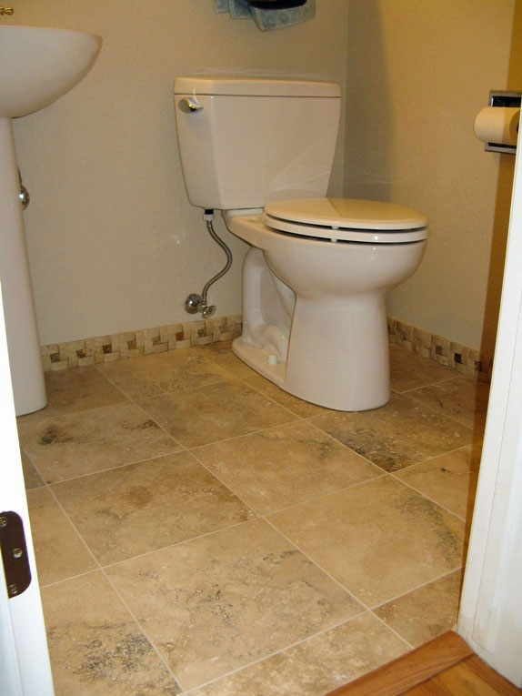

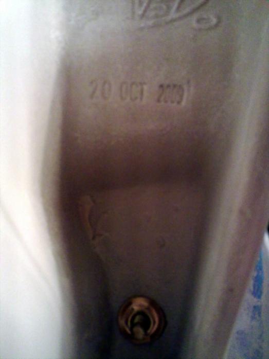

    just installed Champion 4 this summer, the inside stamp says 2005, it has the blue seal. You can hear a constant dripping when you listen next to the tank. I pushed down all around on the top of the seal. Could it be leaking from another location than the blue seal? The tank will refill approx every 10 min. AS is sending me a new seal.

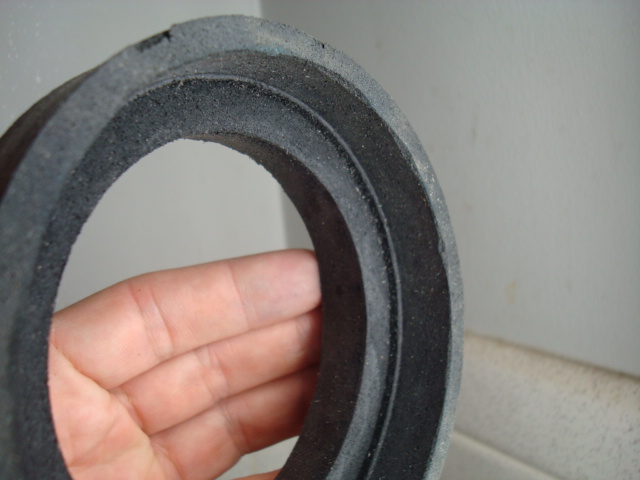

    My next dreaded obstacle was the HUGE tank to bowl o-ring seal everyone likes to complain about... and/or... the dreaded "Tank Wobble"). After reading numerous threads and complaints about the two it became obvious that one effects the other. Yes... the gasket is super thick. (I couldn't help but wonder why a thinner silicone gasket wouldn't be just as good) Anyway... if you don't tighten the tank until it contacts the bowl then the rubber gasket will allow the tank to wobble. (DUH!) I even read the earlier thread about modifying the gasket with a router. Although I own several routers I figure the seal was designed this way for a reason (although it escapes me) and I was going to use it as designed or bust the toilet trying! As mentioned by others, American Standard customer service says the only way to prevent the wobble and leaks is to tightened the tank so it contacts the bowl "front and back". Response: "Don't worry about the tank or bowl breaking, just tighten the bolts evenly until the tank and bowl surfaces touch, then stop."
    Believe it or not, using only my bare hand to grip the deep socket wrench included with the toilet... I was able to tighten the nuts enough to establish contact between the tank and the front of the bowl. However, the back of the tank was still about 3/8" away from making contact and I could no longer turn the wrench by hand. Using the hole in the deep socket I inserted a screwdriver for additional leverage. I alternated the tightening from left to right. I was determined to pull the tank down until it came in contact with the toilet bowl as instructed or until it busted into pieces. I can tell you it was getting very tight so I stopped to put on some safety glasses. I felt I was tightening the bolts beyond where I would have normally stopping in fear of breaking the toilet. But... a couple more turns on each nut and Bingo, I had tank to bowl contact, front and back!
    Let me tell you (regardless of what you may have read in other threads)... if you tighten until the tank touches the bowl front and back there is NO TANK WOBBLE... NONE! (It feels as solid as some one piece toilets I've installed) That said, I don't care for convex curve of the tank. It encroaches the upper back when sitting, forcing you to sit straight up.
