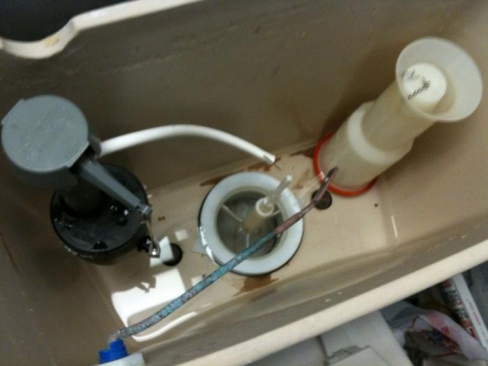

    I can't tell you how validated I finally feel after finding this website. I have two Champion toilets that I installed about a year apart in 2006 and 2007. I have experienced the three problems everyone describes here:
    1. Toilet no. 1: Handle "misses" or disengages occasionally when flushing.
    2. Toilet no. 2: Flush valve broke apart. I took out the mechanism and simply looped a stainless steel ball chain through the hole in the remaining stopper piece, and through the hole in the handle rod, and its the best flush you ever saw. I just hold the handle down a bit longer for an even more powerful flush.
    3. Both toilets began to run incessantly and drove us crazy.

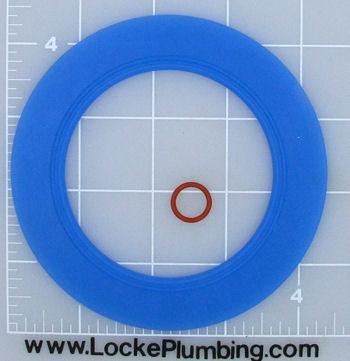

    I'm really glad I found out on this website that you could buy replacements for the orange gaskets at Lowes. I bought two, put them on, and the running water problem is solved!
    I do love the flush action and the fact that the toilets never clog. I guess I'll need to get the new flush valves eventually. Anyway thanks to everyone for all their suggestions and experiences on this forum.

    just installed Champion 4 this summer, the inside stamp says 2005, it has the blue seal. You can hear a constant dripping when you listen next to the tank. I pushed down all around on the top of the seal. Could it be leaking from another location than the blue seal? The tank will refill approx every 10 min. AS is sending me a new seal.
