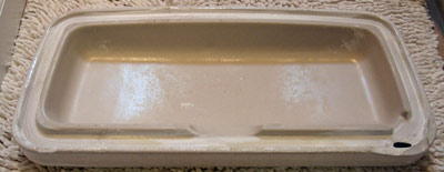

    I bought a newly-contructed condo 2.5 years ago, and it came with an American Standard toilet installed. I've had the flush valve break on me twice already, and I'm at a point where I simply want to replace it with something new. As far as I can tell, I think it is a Champion 4, but I am not very experienced with toilets, and I'm having difficulty verifying this. Here is a photo:
    http://www.terrylove.com/forums/images/attach/jpg.gif
    I was hoping to confirm that this is the Champion 4, and also find out what I should buy to replace it? As far as I can tell, it seems that American Standard has released an upgraded version. My building has a new super, and he told me he could get me a new valve for $150, which seems beyond absurd and a complete ripoff. If anyone has some insight based on this photo, I would really appreciate it.
  15. #315
    14,207
    That is the original Champion.
    Call American Standard and they will send you new parts to convert it to a Champion 4
