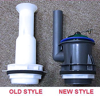

    Thanks everyone! Just called the customer service department and they wanted a model number!?! WTF? So I told them the tower thingy I had and she knew right away what I needed. I'll keep you guys posted. thanks
    Parts for the Champion 4

    Default Champion 4 updated flush valve
    I am still interested in a one piece champion 4 toilet.
    Are they still available and are they finally fixed.

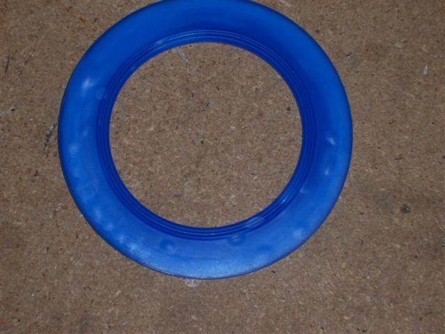

    I had purchased a "water saver" toilet in many years ago when they first came out. I was never satisfied with its flushing ability. Three years ago I bought an American Standard Champion "right height" elongated bowl
    toilet and installed it myself. The DIY installation was not too
    difficult. A problem was with the thick rubber gasket that fits between the tank and the bowl. I tightened the nuts under the edge of the bowl pretty tightly, but the tank still leaned toward the wall. I was afraid that I had done something wrong. I called the American standard help line. They said to tighten until the "piers" on the back come into contact with the bowl. I didn't have enough nerve to tighten that much. I was afraid that I'd crack the bottom of the tank, but I did tighten enough that the tank is almost vertical. I've never had a leak between the tank and the bowl.
    About a year and a half later the flush valve seal( used instead of a
    flapper) began leaking water slowly into the bowl, causing unexpected filling in the middle of the night. I went over to Home Depot and picked up a replacement seal for around four dollars. It was a snap to replace. That's more of a maintenance item. I have not had any trouble with it in any way in the subsequent year and a half.

    The flush tower on the Champion 4 has been redesigned, and I am not expecting any problems with it either. It has a 10 year warranty that covers all parts of the toilet including the internal parts.

    OK - time to pile on. After changing out the flush valve to the new and improved Champion 4 flush valve, I thought my troubles might be over. It's been working great for almost a year until recently - when I hear the Champion topping itself off. In less than a year, with soft water and no chemical hockey pucks in the tank, the seal has developed blisters that cause it to leak. I turned it over, but the other side blistered also. It took about 3 weeks to get a replacement from American Standard - of course the big box and local plumbing supply shops don't carry the seal. I was about to order some seals from Locke Plumbing when it finally showed up. I've read that the Cadet 3 flappers also blister. I hope Korky or someone starts making replacement seals soon, because the AS seals are crap.
