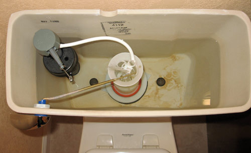

    Unhappy Another dissatisfied Champion toilet(s) owner...but wait, there's more!!
    Just found this forum...wished I'd found it earlier, like two years ago when I bought two of those pesky Champion (Williamsburg) toilets.
    I, too, am plagued with leaky (and extremely noisy) flush valves. Both toilets are problematic. I have been getting middle-of-the-night phantom flushes (both toilets--different nights, fortunately) due to the leaky valves causing the tank to refill, plus incomplete flushes when I do flush the toilets.
    I saw Terry's photos (at least, I think they are Terry's) of the valve seal replacement and of the replacement flush valves. I've done the valve seals bit, with no success. So...I (just) phoned American Standard (800-442-1902), and after a short wait, spoke with a representative who was very courteous and promptly took my name and address. He also asked for the model number (etched inside the tank, starting with a "4" and is 4 digits long, of each toilet--was the same number) and told me they would be shipping me a couple of ("free"!!) replacement flush valves. It was a painless procedure and I didn't even have to complain about the lousy toilet, other than tell him the flush values were no good...and no parts were available to fix them.
    I should receive my two replacement flush valves within 10 days, the representative informed me. A big "THANKS" to Terry for this forum and for posting the photos of the replacement flush valve. By the way, I think the American Standard telephone rep was somewhat surprised when I replied to his "the replacement valve will look different than the one you have" that I knew that because I'd seen a photo of one.

    Smile Follow-up on Champion flush valve replacement
    As was promised, American Standard sent the two replacement flush valves as well as two new tank-bowl gaskets and hardware, all within the ten days they stated (via the phone order).
    Had a little problem with the new flush valve's chain hookup to the handle stem-arm since the replacement setup involved a pin and cotter key attached to a chain. The pin was too large to go through the holes in the handle stem-arm, so I just hooked it up like it had been with the old flush valve--a wire s-hook through the hole in the arm and the other end crimped around the chain.
    It works great! No more loud "clunk" when the toilet is flushed plus a much improved flow of water into the bowl. This looks like a "win" for us...and a pat on the back for American Standard. They stepped up, admitted the error of their ways (i.e. the bad piston type flush valve), and replaced it with the new-and-improved flush valve (free!).
    Yes, it was a hassle. But we had installed our own Champion toilets in the first place, so pulling the tank off, removing the original no-good flush valve, installing the new-and-improved flush valve, and then re-seating the tank to the bowl was not THAT big of a deal.

    I'm responding to several of these kinds of questions this evening...it must be Champion flush valve day...
    Yes, the replacement flapper-style flush valve is definitely worth the fuss and bother of requesting it from American Standard and going through the pain-in-the-rear installation process. You definitely will be pleased with the results...no more leaking in between flushes, no more incomplete flushes, no more frustrations with your Champion toilet (hopefully!). I noted that after we changed out the two Champion toilets' flush valves, it was like we had brand new toilets...a world of difference!
    Go for it!
    One thing we discovered, however, was that the clevis pin hookup for the chain from flush valve to flush lever arm did not fit into the too-small holes in the flush lever arm. I simply removed the clevis pin from the new chain and re-installed the simple s-hook from the old chain to the new chain and to the flush lever arm...problem solved...and it works perfectly (even impressed my spousal unit, who did most of the work removing the old piston-style flush valve and installing the new flapper-style flush valve!).
    I will add that you need to be very careful reinstalling the tank onto the bowl...make certain you use that deep socket and perform the alternating-sides tightening routine. I have read many complaints about leaking tanks but if you are careful, take your time, and seat the tank, gasket, and bowl tightly (not too or you'll break the ceramic!) and EVENLY, you will have 100% success. We learned the hard way...on our second Champion, we hurried...we were flush with success from the flush valve replacement of our first Champion, earlier that day. We tried to do the tank-to-bowl bit quickly...that is, we did NOT go from side-to-side after each series of 2-3 cranks on the ratchet. Oh, man...water ran out of the tank onto the floor at about 100 gallons a minute! Lesson learned...we started all over and did it the RIGHT way, the SECOND time, with success!
