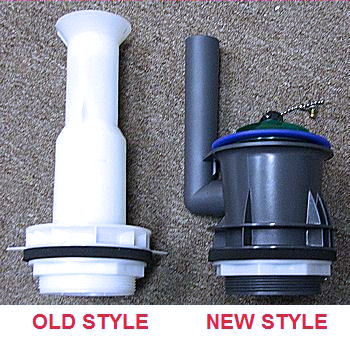

    If you have the old style flush valve on the left, call American Standard Tech Support and they will send out the new flush valve on the right.
    Confirmed. My Champion was installed early 2005 (4260). A.S. is sending out the refit kit gratis.

    Installed the new flush valve today. Went in as expected, no issues. The flushing system sounds better (no more "broken clunk" feel). I'll be able to put it to the test after my 2 cups of coffee tomorrow morning.
    BTW, that tank seats just right on the toilet. It's not fully seated until the front and rear ribs touch. Don't use a screwdriver on the screw in the tank, use a 1/2" long socket from underneath.
    **EDIT** - put the Champ through the real world paces this morning. It's still "The Champ" and does what's intended.

    We have four American Standard Champion toilets purchased and user installed in 2004. We've had three flush valve problems with the single one-piece toilet, one involving a seal leak and two involving broken parts. I called American Standard. They sent the new grey replacement flush valves for all four of our Champion toilets free of charge. I installed the replacement flush valve for the one-piece toilet which was easy since replacement does not require removing the tank. For the remaining three toilets that have model 4260 tanks, tank removal will be needed. I will do that one-by-one as the other toilets develop flush valve issues. The new flush valves get rid of the "clunk" issue during flushes. The blue seals for the new flush valves are considerably thicker than the red seals for the old flush valve assemblies. I am hoping that American Standard gets the message that parts such as seals for the new flush valves should be made available at Lowe's and The Home Depot.

    We had the new parts that Champion mailed to us yesterday, works fine now, also my grandson's father that installed this part advised that Walmarts has the exact same parts they are Universal and work. He said that they just cost $7.00.
