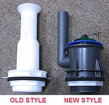

    We bought three and all three are having the same problems of the red gaskets leaking causing a refill every hour, handle disconnects, inadequate water flow through the bowl, the "clunking" noise during the flush activation and a proper tank setting.

    I bought American Standard and Korky replacement flush valve seals and neither stopped the problem on my one piece #2004 Champion.
    As I was turning the cylinder that the ring mounts on I noticed that there are three "ears" on the cylinder and three nubs where they land in the seat area.
    I used a standard plier to grab each ear and bend it up. I reached in through the slot where the float that has some unknown function mounts.
    Now the seal ring is able the press down on the seat and it seems to work fine.

    Here is the warranty number from the A.S. web site - (800) 442-1902. They sent me the newer replacement flush valve, no charge. It is kind of a pain to install, due to the location/access of the tank bolts, but the newer flush valve works much better than the old flush tower. You can also buy the replacement flush valve here:

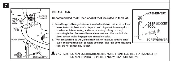

    Yes - you do have to remove the tank. You'll need a ratchet with deep sockets to get to the tank bolts. Here's how it's done:
    http://www.plumberprotects.com/flushology_champion.htm
    Take a look at the clip labeled 'How to update the Champion toilet with the new 4" Accelerator Flush Valve'. I'm just a home-owner with a modest tool box and it took me less than an hour. I've had no problems with this new flush valve, and 2 teenagers haven't been able to clog the Champion.

    I just used a sponge to mop out the remaining water in the tank. I wish I had the amount of room to work in that they had in the video. I was working in cramped quarters, and alternating side to side while slowly tightening the well-hidden tank bolts did a number on my back!! I don't know how you guys do it for a living. Must go through a ton of tylenol.

    It's simple. Smart plumbers don't install a beast like the Champion.
    The Champion was one of the hardest installations ever for a toilet.
    You would have to be some kind of masochist to want to install them for a living. They are way too heavy for a two piece toilet, and like you mention, the tank bolts are very hard to get at.
    Other brands are much easier to install.
