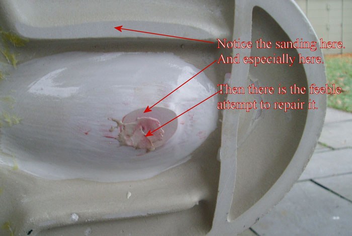

    I purchased 3 AS Champion toilets for our new home. Within a few months the periodic flushing began. First with one then all three. Upon discovery I found all 3 red seals to have a small "bump" approx 1/4" x 1/4" on the edge of the 3 seals. Thinking they might be defective, I purchased 3 seals at Home Depot for almost $6 each. Fine for a month then problems recurred with same result. More red seals, more leaks. Finally after 3 each seal replacements I contacted American Standard. They said I had the "old"
    models and they would ship the replacement tank parts complete for all 3 toilets which they did. Fortunately I was able to act as the plumber here which saved us huge sums of money but if I weren't able I shudder to think how much more we would have had to spend on each and every call.
    Everything was fine for the first 7 months then, voila! Then the "new"
    green seal developed a 1/4" x 1/4" bump near the edge just like the red seals!! Two calls to AS Customer Service with a direct request to talk to a qualified, ranking design engineer resulted in several rebuffs and finally a call back several days later by someone identifying themself as a design engineer.
    Our story is this. My wife is a regional/national accounts manager for GE's water treatment. We are on a well and because of this paid for a 150 point water test in a nearby state's lab. The results were used to design a whole house system by GE engineers for our home as we are a Beta site for water testing for GE.
    The AS "engineer" upon learning of this said it must be our water quality causing the bumps not the Champion design. He sent 2 vials for us to fill up with water for AS to "test".
    After reading numerous blogs of disatisfied customers, I trust AS does the right thing and responds very quickly to our concerns "in the field" as the Champion falls far, far short of quality claims.

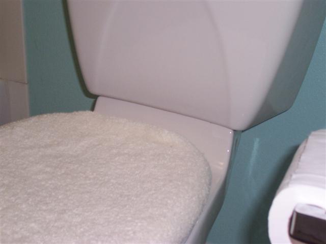

    on Americans, but buddy, the top and the tank are stamped with Made in Mexico. Now maybe that is where Americans work now, but all I know is this toilet is an evil water running machine that has become the bain of my exsistance. No wonder when I first went to the AS website, they were so pleasant to look at...but no mention that the Champ was the evil toilet that is evil. I am sorry people...I just at the thing.

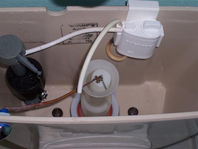

    American Standard evidently realized that the engineering on the original Champion – Flush Tower was not perfect. They have since replaced the original Champion flush tower system with the new and improved Champion 4 flush system. The Champion 4 flush system works even better than the original with none of the problems.
    Original Champion toilets can be retrofitted with the new Champion 4 flush system and enjoy a problem free product. Call American Standard customer service for more information (Ph 800-442-1902). There is also a video showing how to replace the old flush tower with the new Champion 4 flush kit at http://plumberprotects.com/flushology_champion.htm .

    I'm the guy that put the Eljer flush valve in the Champion. That was over a year ago, and I am happy to report that I have never had a leak, and get a perfect flush every time. Since I am able to modulate the length of the flush, I get complete removal of residuals on the first flush.
    If you still have the old style flush tower (I pity you if that is the case) then HURRY and get the Eljer flush valve- now only $12.00 at Locke Plumbing! No leaks, no running toilet, and no double flushing... it will be the best $12 you ever spent!

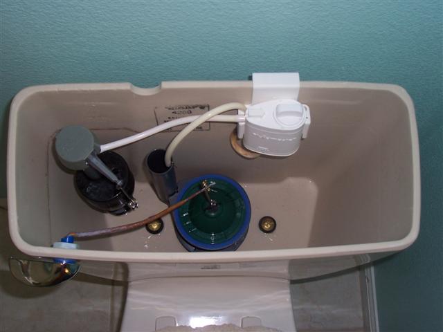

    Finally got around to replacing the flush tower with the replacement flush valve sent by American Standard. The new flush value works great. Very powerful flush and good bowl wash. I would recommend that anyone having problems with the original Champion flush tower, to call AS and request the new flush valve. It came with new tank bolts, seals, and a new spud gasket.
    old flush valve (hose clip already removed), new flush valve, got it tight (no tank wobble), but not too tight... I took my time and slowly tightened the tank bolts, a little on each side. It took less than an hour to replace. -dog
