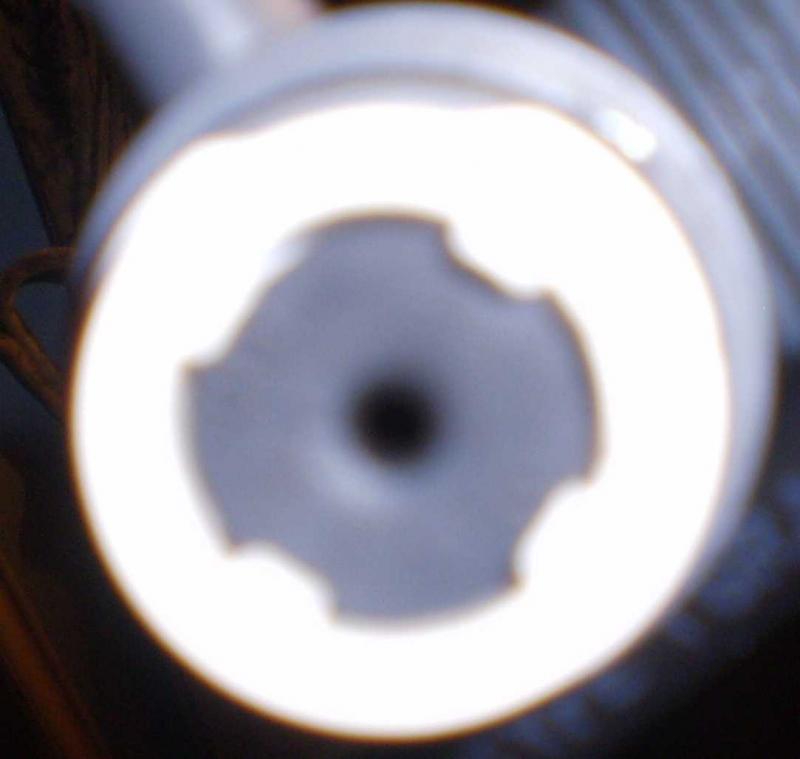

    The slow drain line flow has to be fixed before you'll get much suction. Make sure the DLFC button is in in the correct direction, the rounded shoulder (of the hole) in the button has to be facing toward the control valve.

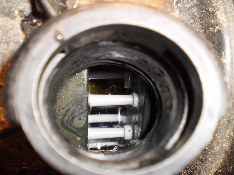

    If the stack is not indexed correctly in its hole in the valve body it will cause water to go into the salt tank when it should not be. You remove the drain line elbow and look down in the drain line elbow fitting hole as you install the stack. Directions should be in your service manual but... you tighten it until the seal disappears and then stop. If you still have water going into the salt tank, you need a new stack and pistons.

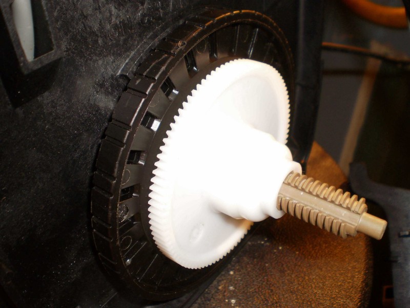

Size:  32.8 KBName:  Drive Cap Assembly.JPG
Size:  87.2 KBName:  Stack through drain hole.jpg

    Dear Mr. Slusser, waiting for my 1002 error code to go away do I can check drain flow. Just a quick note about replacing the stack/pistons. My proceedure was: Tigten the black circular round "nut" with the plastic wrench to "pretty tight". Then manully turn the white gear clockwise until "just barely tight". Then install the front cover assembly. Thanks again, Doc

    As you get tighter there is essently no movement...? The white gear, I turned clockwise all the way (see coming photo) before attaching the motor bracket. That is the only way you get movement to the stack ass., correct (the white gear)?. The DLFC is correctly orientated (funny how that would make a difference). Three photos coming (if I can drive this...ha). Thanks again!!!
    The stack does not move from it's position but, rotating the white gear moves the pistons inside the stack (seals and spacers) and with the stack positioned incorrectly, the pistons will not seal in the right position of the individual seals. A leaking seal on the brine piston and you get water going into the salt tank when it shouldn't be. Actually that is in all positions including service.

    And if you look at your 3rd picture, down the drain line fitting hole, you can see about 1/3rd of the hole is blocked by a part of the stack, at least I think it is, and you said you have a low drain line flow... no wonder. lol

    [QUOTE=Gary Slusser;355104]Good'n snug doesn't sound like it was positioned correctly to me unless the instructions say good'n snug.
    No, actually the black obstruction, both to the right and left is the housing "bore". That doesn't move obviously. I have the open part of the stack in the open part of what you see as open, with seals on either side. It is in the correct position unless I'm really missing something here. If it were any looser it would not seal and then it would obstruct a bit of the opening, but not much. If it were just ever so slightly tighter it would hit the back of the housing inside the bore. I have ordered a new stack/pistons assembly and should receive it today or tomorrow. We have a job on Saturday so I might not get it installed until Sunday. I do want to install it properly. Again, are you sure you are seeing something amiss in the photo?
