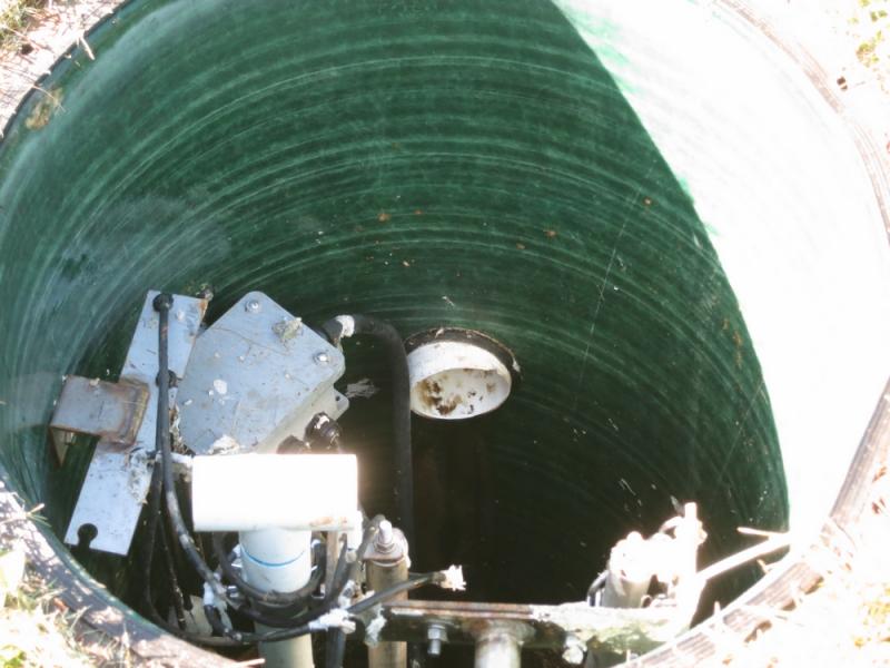

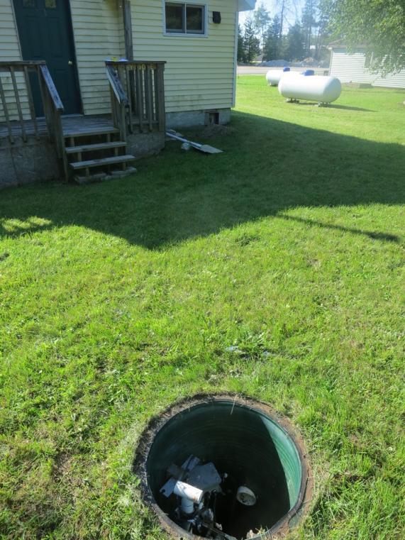

    And apparently I'm using incorrect terminology by using the word cistern (did I mention I'm not a licensed plumber?) Here's what I meant:
Size:  98.9 KBName:  Plumbing 01.jpg

    Where does that pump tank pump too?
    To do it right, you will probably need to open up walls and such to run vents

    This was put in when the township put in the sewer system, so I'm assuming it pumps it to the main waste lines?
    21,434
    You would only need that if your house was below the main sewer line, which obviously, it is or they wouldn't have installed one. A cistern is essentially just a big tank for storing stuff (typically water, not sewage).
    There are lots of rules on where and how vents are installed. Some general ones, the distance between the trap and the vent has limits based mostly on the diameter of the pipe - larger pipe, the further you can go to the vent. Once a vent, always a vent (IOW, a vent can't be used as a drain, but above a drain it can become a vent). Vent lines must slope like a drain system, since they can accumulate moisture from the roof penetration (rain, snow) or condensation. There are lots of other rules which include the types of fittings required and their placement and orientation. That's one reason why a plumber is an apprentice for years before he can become a licensed practitioner.
    To adequately help, a good drawing of what's there might be sufficient, but without seeing what's there, it's really hard to tell you what's required to bring things up to code.

    So what's the correct term, is that a lift station?

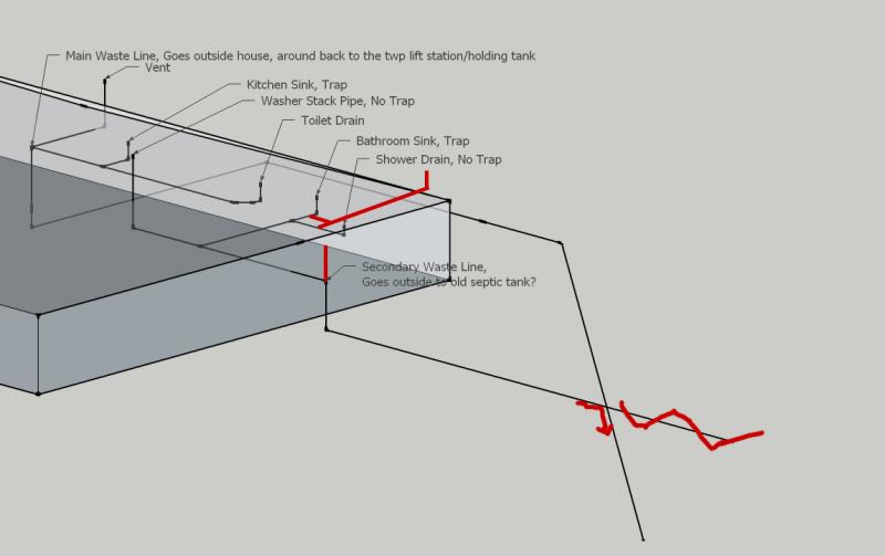

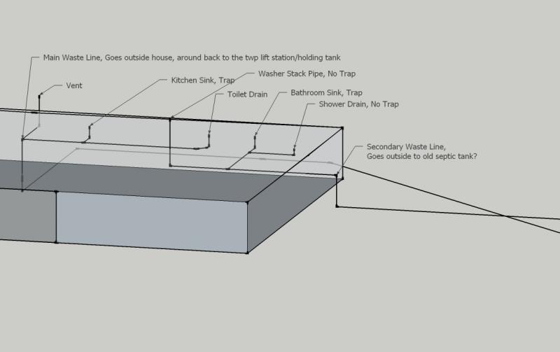

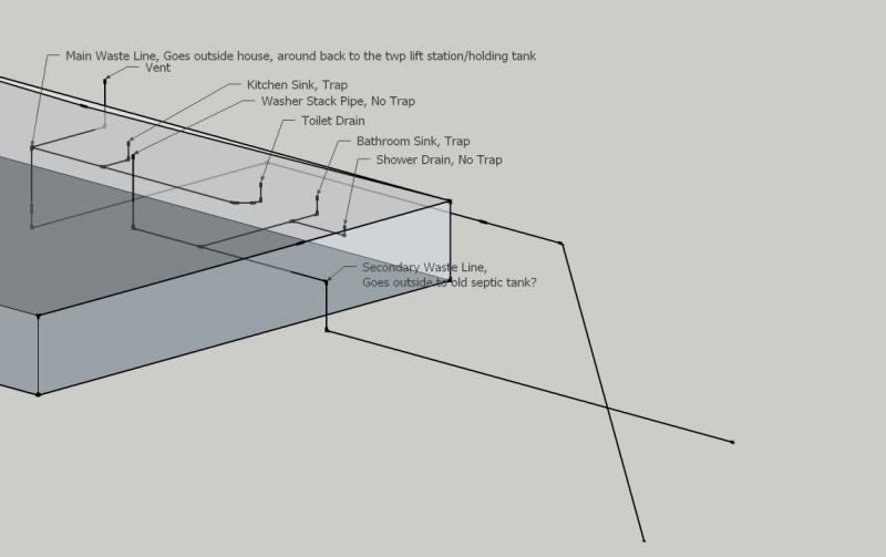

    All right, here we go... Here are some drawings that hopefully give a better picture. The top flat layer is the floor of the house. The bottom layer is the ground of the crawl space.
    Basically I've got two different waste systems:
    1) the toilet and kitchen sink that go through a 4" line to the middle of the house, vent out to a pipe on the outside of the house, and goes down under ground, toward the back of the house, and connects with the lift station/holding tank before getting pumped to the township sewer system.
    2) the bathroom sink and shower drains that connect up (all via 1.5" line) with the washer line, out the house, down into the ground, and out to the old septic tank (I'm assuming).
    I'd like to connect the second drain system with the first main system. I thought it might be easier to do that by connecting it out in the yard. So I'm asking for feedback on that decision.
    BUT, I recognize that without vents in those three fixtures in the second system, I'm going to have issues. So I'm wondering how to vent those with limited room in the crawlspace and without tearing apart the walls.
    Looking at the red markings:
    1) can I add piping at those locations, tie them together to a line that goes outside right there, and then put a vent stack pipe along the outside wall of the house?
    2) Or, could I put a vent stack pipe where the united connection comes out of the house? Or will that not work because it's downhill of all the fixtures? And, it's one, not three vents?
    Last question, if my only vent on the main system is downhill of the toilet and kitchen sink, is that even doing anything? Doesn't the vent need to be uphill of the fixtures?
    Thanks for any feedback or observations!

    21,434
    You can tie the existing stuff into the main line, but in most places, anything underground has to be at least 2". From today's viewpoint, the kitchen sink, washing machine, and shower should start out at 2" and probably be bigger once they join up. Having the WM on the same line as the shower and other things at a 1.5" pipe is asking for slow draining and backups.
    EACH trap needs its OWN vent (there are a few exceptions, but since the toilet is already going to the main, I don't think you have one of those situations where you can wet vent anything. Without a vent at each trap, you likely haveteffectively S-traps, which actually empty quite well, in fact, too well, and they siphon themselves dry, if not by themselves, by water running past them from another trap!
    Venting each trap doesn't mean you need that many pipes running up above the roof, but the rules to combine them are fairly specific. They can be combined at 42" above the floor or 6" above the flood plane of the highest fixture whichever is HIGHER. How you connect them, the fittings you use, and the way it is connected is critical to be considered an actual vent.

    So, with the understanding that vents and traps are required, I would appreciate any feedback on one of my earlier questions:
    Quote Originally Posted by wetzelja View Post
    2) When I followed the 4" drain, it goes downhill from the toilet, past the kitchen sink, and then down into the ground. It appears that somewhere near where it turns and goes into the ground, there must be a connection for a vent that comes out of the house. Is that proper venting? Isn't the vent stack supposed to be uphill from the fixtures, not below them?
    With this setup, is this even functioning as a vent?
    21,434
    To be a vent, it has to go up from the trap. Anything that comes off the drain line after it is below the trap can't be a vent. The whole idea of the vent is that it must be able to move air in the system while waste flows out...if it's below, then the waste could block the vent from operating.
