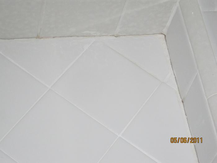

I'm replumbing a stall shower that had an obsolete two knob valve on 8" center. The tile is good and I have full access to the back. I already enlarged one of the valve holes in the back to accept a new American Standard R120 with pressure and volume control in one.
