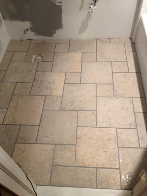

    I put the grout in last night.. and ordered wainscotting for the bottom 36" of wall.
    When I do install the toilet.. can I use the wax rings and bolts that are in the toilet box, or should I get new ones?

    I would look carefully at what they give you in the box, because it's not always the best quality. Frankly, if I were going to spend money on something, I would get myself a better set of tank-to-bowl hardware, as many of the reporting professional on here do with this toilet. I would likely get a decent set of closet bolts, meaning made out of an appropriate material in a good thickness, with two nuts: one to nut to the flange and another to secure toilet to flange. As to wax rings, if you have the flange at the proper level, which you will here, a standard-thickness wax ring should suffice; when using a single wax ring, many posters here recommend the one without any kind of plastic horn or flange built-in. Of course, it couldn't hurt to have a good, thick wax ring...

    Quote Originally Posted by coldsolderjoint View Post
    Just out of curiousity, why do you feel that the bolts and wax ring are any different than what you'd buy yourself? Are they not brass bolts, or long enough?
    On my last toilet installation, I used the Sani-Seal ring instead of a wax ring. Its not very long ago, but it is very neat to use and I liked that part of it. I have had no leaks with it, and hope it lasts as long as the wax ring that was under the old toilet that I replaced. time will tell

    I was just curious.. i still havent taken the toilet out of the box yet.. and i saw last night on the side of the box that they where included.. so given that the pro's here don't really like american standard.. thought they might not be putting good hardware in the box.

    I was thinking of replies 4, 5 and 6 of This Thread (Click Here).
    The Wolverine Brass tank-to-bowl set that the poster iin that thread mentions isn't sold to non-plumbers by Wolverine, but there are similar ones out there at any good plumbing supply place, or online. Look up Lasco 04-3675 for the kind of thing the posters are discussing.

    I don't mean to torture you into spending 5% of the price of the toilet (and 50% more than you spent on paint) on a tank-to-bowl set when the AS one may work just fine. That set I mention might be perceived by some as quality-overkill, but I'm pretty sure that once it is in, there will be no leaks and the tank won't be going anywhere. So one option is of course to check out what's in the box, see if it looks like it's going to work, and have the knowledge of this stuff as a fallback if there's a problem soon or down the road. Also, you can check out Terry's toilet install kit; he has said that he includes the brands that he particularly likes. If for no other reason, you can check it out to see what he uses when installing toilets. It's under shopping, near the bottom of his list of toilets and such. At the bottom here: http://www.easycarts.net/ecarts/terr...o_Toilets.html
  10. #25
    21,379
    If the supplied hardware is solid brass or SS, it should be fine. If it is plated, it's probably not the best thing to use. And, they probably do not include a second set of nuts and washers which can really help.
