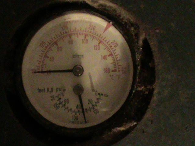

    What is the pressure on the boiler? Your pressure reducing valve that feeds the boiler can also be bad.

    If I am reading that gauge correctly, it is 35 PSI... and I do not see an adjustment on the pressure reducing valve. How much pressure should the water on the boiler have?

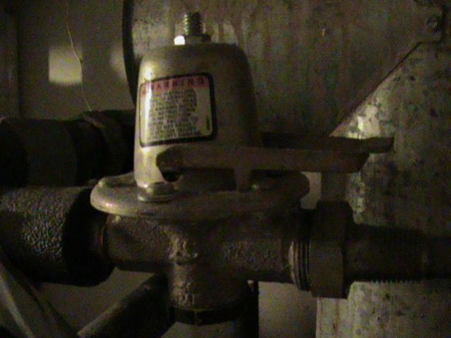

Size:  35.3 KB Here is a pic of the reducing valve I have... I cannot tell the brand, I know that the watts brand is very simple to adjust the pressure by losing the bolt, and turn the top section. Anyone knows if this one can be adjusted and to what value? Thanks

    It's adjusted by loosing the screw in the top. But they don't just go out of adjustment. But they do fair and need to be replaced. According to your temperature gauge the boiler is off. If it is off the high pressure shows that the problem is in the feed valve. The pressure relief valve is doing it's job.
    John
    21,405
    A typical boiler operating pressure for a residential system is in the area of around 12-16psi (around one atmosphere). Some need more, but look at the relief valve, it's probably a 30psi version - a 2x safety factor is pretty common. It's pressurized to prevent the boiler water from boiling in the heat exchanger.
