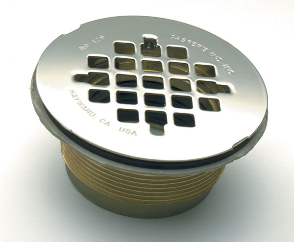

    I am about to set a 32" shower stall in a corner of a very small bathroom - new construction, and the floor is slab on grade. The PVC drain (and trap) in the ground below the slab is not yet installed and final concrete not yet poured. The floor of the shower stall is plastic and instructions are to glue the drain fitting directly onto the drain pipe.
    I have strong misgivings about the irreversibility of this step. If a mistake is made or if at any time in the future it is desired to change the shower stall or if it is ever damaged and needs replacing it will be impossible short of jackhammering out the concrete and the below slab drain pipe, and destroying the shower stall to make any alterations or repair.
    Does anyone know if it is possible to get an O-ring or gasket that would make a seal between the outside of a 1.5" PVC pipe and the inside of a 2" PVC pipe ? If so, I could glue a short 1.5" extension of the drain on the bottom of the shower stall and slide it into the rising 2" drain pipe below the slab. Then, the whole shower stall bottom could just be lifted out from the 2" drain pipe at anytime in the future. The seal between the 1.5" and 2" pipe would be made with the gasket or O-ring.
    If so, what is this called and where can I get it ?

    It is impossible to do what you are asking. You can get a new drain fitting, however, which does use a gasket to seal to the pipe.

    Yeah thats what HJ is saying. You can buy another type drain that uses a rubber gasket to make the connection to the drain and pipe. You install the drain onto the base and then drop the base into place. Then the rubber gasket slips between the drain and the pipe from the top. A compression ring is provides to compress the rubber gasket.

    Sounds like junk.....I like the brass drain with the brass compression ring.....AKA no caulk drain.

    These all sound like it is necessary to have access under the floor. For example, to tighten the compression ring ? As I said in the beginning, this shower stall is being installed on a concrete slab on grade. There is no access underneath. The plastic drain fitting provided is meant to glue on to the end of the rising 2" PVC drain pipe. It looks like the only way is to mount the drain in the floor of the shower stall, paint PVC glue on both the end of the 2" drain pipe and on the socked in the bottom of the PVC drain fitting, then place the entire shower stall floor, drain fitting and all, on top of the glue-wet 2" drain pipe and the whole assembly will set and be glued permanently in place in 5 seconds. No access after that is possible. Any mistakes mean nothing could be done except cut the shower stall floor into pieces and jackhammer the floor.

    The compression ring gets installed from the top. So does the rubber gasket. stub the pipe up and drop the shower base with the drain already attached over the pipe stub. Trim the pipe to the proper height. Install the rubber gasket. Install the compression ring. Snap the strainer on. Finished.

    Hundreds, if not thousands of cemented shower drains are installed every day. When done correctly it will last a lifetime. If you do need to remove it, it's a simple matter of cutting the pipe off from the inside of the drain with an inside pipe cutter.
    Most shower bases will require a 3-4" diameter recess in the floor for the shower drain, which leaves plenty of room to couple in a new drain if it becomes necessary in the future.
