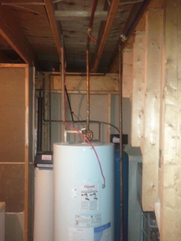

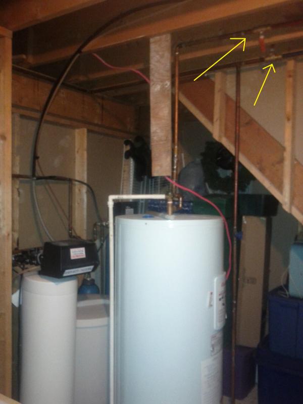

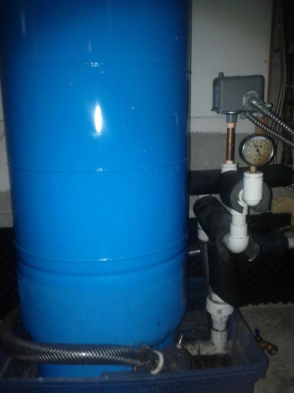

I've been trying to do more investigating on the loss of pressure in my pressure tank as per above post. I will try to provide as much detail as I can.
To try and track down the source of the pressure loss I have trying to inspect plumbing from every valve I have access to open and close, I have attached some new pictures to help maybe illustrate more

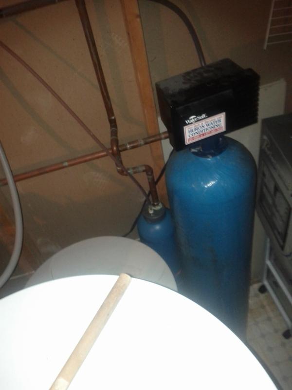

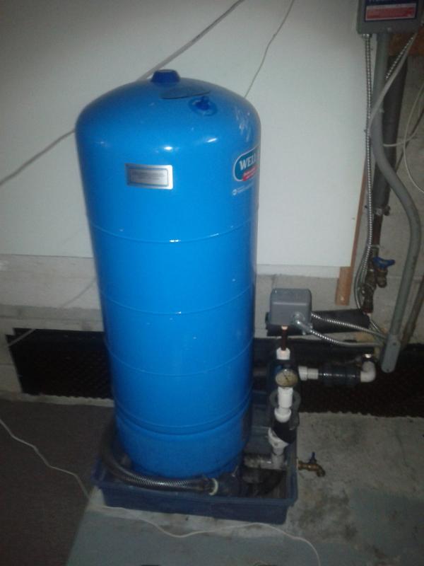

From the water pressure tank the cold water line is 3/4'' dia and goes vertical about 10 feet up the wall and then about a 25 to 30 foot run to the first (small) blue tank which is then fed into the larger blue tank (Iron Filtration system)
Then from the Iron Filter tanks into the white water softener tank on the right.
From there it goes out into the house main branch for cold water and into the hot water tank.
Pictured in one of my supplied photos I show the location of two 3/4'' ball valve valves which cut hot and cold to the house right after the hot water heater and cold from the softener.
As mentioned before with the house main turned off near the water pressure tank the tank the tank will hold 50 psi.
With that main on feeding the house and the 3/4'' ball valves closed show in the included picture I assume the only section limited to the pressure now should be the main line from the pressure tank to the softener, iron filter and hot water heater and nothing else.
With those valves closed in about an 1hr 30 min time the pressure gauge has dropped 12 psi from 50 to two ticks under 40psi
I still cannot find any leaks in the main line and or around any of those tanks pictured.....
Anyone else have any thought?

Check the drain lines on the softener, iron filter, and HWT to see if one of them is flowing to the drain.

I can't hear it running in the waste drain pipes...but just by lightly tapping on the drain lines from the softener and the iron filter I can confirm there is definitely water in those lines.....
The iron filter drain line is clear in appearance (1/4'' maybe) and I can see water all the way up to where it is tapped into the waste drain.
And the softener drain line is a black hose almost like a garden hose (1/2'') and when i tap on that hose were it is plumbed into the waste drain pipe I can hear water all the way up to the end of it as well
HWT drain valve is dry...looks good
You can see a good look at these two lines in my 2nd picture the brownish small line going vertical is the iron filter hose and the black hose going vertical is the softener hose

Sorry..it would be helpfull if I gave more information...umm I dont much about the equipment itself.
If you take a peak at my first photo in my second post above see the little blue tank...there is a small 1/4'' hose coming from it going up vertical to the nearest waste drain pipe..you can see in the photo it is reddish brown..but it is clear right at the end where it goes into the waste drain.
Also in the same photo coming out from behind the black box on the iron filter there is a 1/2'' hose which is also reddish brown (almost black actually) that goes from the iron filter and goes into a tee with the drain from the water softener.
Maybe the little tank is something else but I was told it was part of a iron filtration system.

Well I got up again on my step stool and grabbed the drain hose from the softener and iron filter.....and it is as cold as a cold water line in the house....I can hear water in the line when I jiggle it...but can't hear it draining into the waste pipe....it may be a small but steady leak inside I assume.
I will have to have some come check it out....I had no idea because of the fact the drain hose goes up...that such a leak may still occur.

I was assuming that your systems had bypass valves that... umm... bypasses the system so that it is essentially off. The bypass is a tandem pair of valves that close to/from the unit and opens between the in and the out.
Maybe you don't have bypass on your units.

I had the original installer of the iron filter come out
Pulled the drain hose off and water poured out non stop.
Pulled the tank piston and replaced the seals but the piston is still leaking and he doesn't have replacement till next week.
So he has put the filter into bypass which has stopped the leaking and psi loss.
He said I should be good for the weekend in bypass till early next week till he can get a new tank piston
