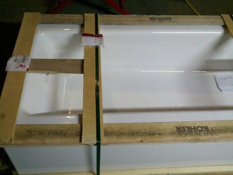

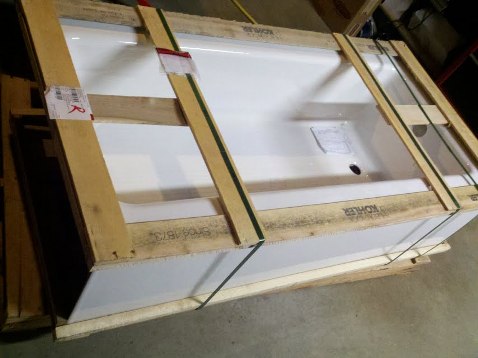

    The tub arrived today - very nice. I like that the slope at the back of the tub isn't as dramatic as the Villager.
