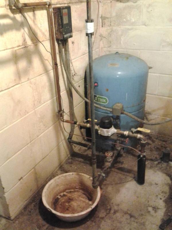

I believe it is a 160' well with a submersible pump. See picture below. I live in Minnesota.
I had noticed last week that although it was working normally, it seemed to sound like it was cycling faster than usual. Then a few days later it stopped entirely. I went down to the basement to investigate, and where the control box and pressure tank were, there was a noise coming from the control box on left (relay switch?) "ting....tock......................ting....tock......................." at about 10 second intervals. Pressure gauge read zero. I turned the power off at the breaker as I didn't have time to deal with it. The house is on city water, the well is just for lawn and garden. It's an older well so I assumed the pump just went out and would need replacement.
The next day I turned it back on to see if it was still not working, and it just continued making the noise, with no water. I left it on for a couple hours to see what would happen, outside faucet open, and some time later it suddenly started working again, and the sprinkler outside started going. It was going for an hour or so before I noticed. I went downstairs to look a it, and everything seemed normal, pressure gauge was at about 40. There is a ball valve there so turned it off to see what would happen, but as soon as I touched the valve actually everything went dead again, pressure gauge back to zero. I tapped on the pressure switch lightly, nothing. I've left it on, faucet to sprinkler open, for an hour so a couple more times, with nothing.
I'm now hoping it's something easier than the pump to place.
Does this sound like a problem with the pressure switch, or relay switch? I know how to use a voltmeter, turn off the power, and not electrocute myself.
Thanks for any help that can be offered.

The tank probably has a busted bladder and is waterlogged, which is why you heard the pump cycling faster than “normal”. There is no such thing as “normal cycling”. If it cycles at all while you are running sprinklers, that is what caused your problems. When the bladder burst from “normal cycling”, the cycling is more rapid, and so is the destruction of your pump and equipment. If the tank is waterlogged, replace it. But don’t just replace it with another tank just like, and therefore have the same problem all over again. With a CSV, like the one in this picture, the pump won’t cycle itself to death while you are running sprinklers, and all you need is a 4.5 gallon tank.
Then repair or replace that control box hanging on the wall before you look at the pump. If the repaired or new control box still clicks and buzzes with no water coming up, you will probably need a new motor as well. Cycling on and off is the main reason for busted bladder tanks, bad control boxes, pressure switches, and burned motors.

I shouldn't say that it was cycling faster than usual, rather it was making the ting...tock............. noise, which I thought at the time was it cycling faster but I don't actually know if it typically made this noise when it cycled on or this is was just an entirely new noise and that's why it sounded different.
Does it make sense for it to be the tank when it has either been working normally, or off completely with no pressure at all? The CSV looks great for my purpose...but a new tank is only $120 down the street, if that is the problem. When I'm running a sprinkler it's usually throttled back to ~4gpm, instead of 8gpm totally open. The pump I assume is ~16gpm.
If I wanted to check and see if it were a problem with the pressure or relay, could I just bypass the relay so it's wired directly on, then turn the power back on at the panel and see if it runs (and cut the power before the pressure gets too high)?

You can manually bypass the pressure switch, but not the control box on the wall.
Throttling the sprinklers back to 8 or 4 GPM with a 16 GPM pump is what causes you pump to cycle on and off. You might slow the cycling down enough for everything to survive if you had about three of those size tanks. But three tanks still wouldn’t stop the cycling like a CSV. And cycling is what causes the ting….tock, that means something has gotten too hot.

You need to describe what is happening between the tick and the tock and between the tock and the tick as well as the pressure readings at the time.
Then you need to take some voltage and current readings after the pressure switch and after the control box.

"Tick" is when the relay gets power and tries to start the pump. "Tock" is when the overload trips. Nothing happens in between.
Ja, probably... but according to the OP, first it worked, then it didn't, then it worked again, then it didn't, then he went off on a tangent about what is "normal" rather than focus on the task at hand. I just wanted the topic to go back to square one.
Putting an ammeter will show if it's drawing too many amps and thermal overloading. A voltmeter would tell what the pump is seeing. An ohmmeter would tell something about the motor and/or wire. If zero water flows, it could be a locked rotor.
