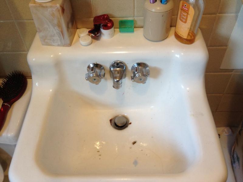

    Hello Guys,
    I'm trying to fix this faucet in my mother's house.
    The center "spout" piece has developed a small crack in the area where the drain plunger/closer rod is supposed to go. That piece rotates off and behind it looks like a threaded 1/4" pipe. I didn't expect home depot to have a new spout.. so I did the next best thing and took some of that magic plumbing epoxy putty and put it in the hole.. it slowed down the leak.. but its still dripping (only when faucet is on).
    This thing is probably older than I am.. and I know the right thing to do is to rip it all out and replace it with an 18" vanity and a quality faucet from Moen, Delta, etc.. but this is a rental house.. my mother is getting a great deal from the landlord (my boss).. so I try to help out where I can. If I do replace the vanity.. I couldn't live with myself if I didn't patch up the floor with new tiles. and you know how that goes.. one thing leads to another and you have no walls left.. and this isn't my house to do a complete bathroom reno! haha
    The perfect solution would be if I found another one of these spouts and could just put it on to stop the leak.
    Thanks

    Can't tell for sure, but code requirements of today probably wouldn't allow that valve set or arrangement. Code wants an air gap between the bottom of the spout and the flood rim of the sink, and if the thing got clogged, you probably wouldn't have the required minimum gap. As a result, I'm not sure you'd find a replacement.

    On that sink there is a proper air gap. It's hard to tell from the picture but the spout is more then high enough.
    As far as parts they are available for that faucet. It's a Central faucet. Most plumbing supply houses will have what you need to rebuild that faucet.

    I'm gonna say either Central Brass or Gerber. Once you know what it is there are lots of places online that can get parts......maybe.

    Thanks Guys.. I'm gunna take this picture and the spout to the local plumbing houses.. I know of 3, but I'm pretty sure they are only open during the week, so I'll have to get creative with the scheduling.

    Looks like they still make them.. but they are over $100.. so when the putty gives way.. I'm just gunna upgrade it to a regular faucet/vanity.. then she will also gain some storage underneath.

    If the piece that's cracked is brass, you could solder or braze the crack and be good for another 50 years.

    I didnt think of that! Good idea.. The guys from John Bridge Tile Forum found the piece I need for $18 plus shipping.

    Whoever make that sink also made the faucet so look on the bottom for the manufacturerer's name, probably Kohler.

    Here is your faucet. It's the same faucet but the handles are a little different.
