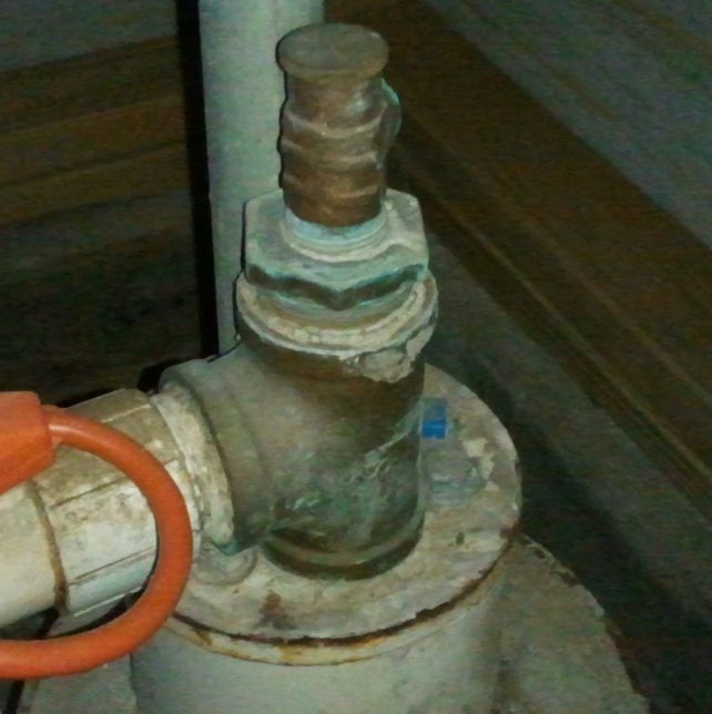

    Is there a HP written on the control box? I think with the amps and the HP on a well running pump, a knowledgeable pump/wellman would be able to estimate the GPM rating.
    One way to calculate the GPM is if the draincock at the tank is large enough, draw off water at such a rate that the pressure holds steady, neither rising nor falling. Then time how long it takes to fill a 5 gallon bucket and do the math.
    I see in the report, the static water level is or at least was at the time 150 feet. The pump is set 20 feet off the bottom at 260 feet giving you 110 feet of reserve. Looks like they rated the well recovery at 10 GPM.
    Have you given thought to putting a pressure gauge at the wellhead where the PRV is?

    Control box is rated for 1 to 1.5 hp. Nothing noted about actual pump installed.
    I will install the additional pressure gauge next. I guess that may tell the story if there is only a check valve at the switch and pump? Any idea of the thread size on the PRV?

    Well... there's your answer about the thread size of the PRV. You could Tee in a regular hose bib and then use a pressure gauge that screws onto it. You could hold your thumb over it and see if there is a vacuum.

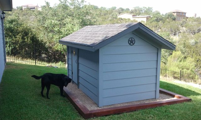

    Maybe a couple of strong men could yard that out by hand, given that the downpipe is PVC and if it doesn't hold water, won't weigh nearly as much. Maybe you could even pump air into the pipe and float it part way out.. J/K. Do you have a hole in the roof for the pipe to go through?

    Pulling it myself has been on my mind for while. I have 2 strong brother in laws and 2 nephew football players that could help me.
    I built the well house so it can be removed in sections. The roof will come off in 1 piece. I'll probably need everyone over to lift it off though. I should have put a metal roof on it.
