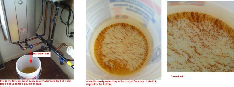

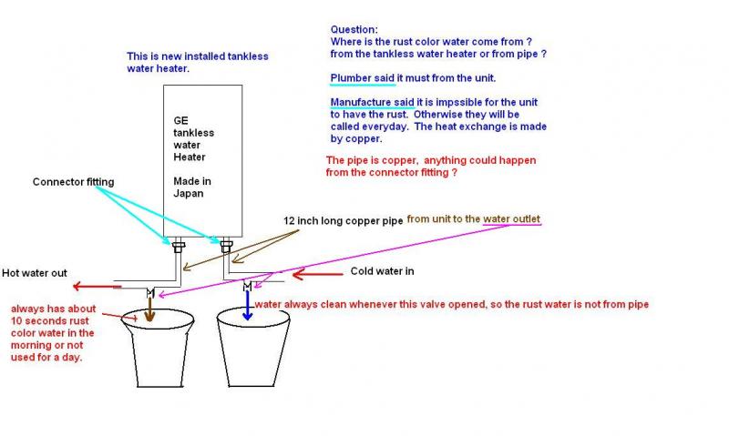

    I just intalled the GE tankless water heater. The hot water line will have about 10 seconds rust like water if it it not used for a day. So every day morning, there is about 10 seconds rust like water. The rust color will be more dark if not use hot water for a longer time. The plumber checked and checked again and said it is the tankless water heater unit problem. Called the GE tankless water technician support, they said there is no any possibility the "unit" can produce the rust because it is make by copper in the heat exchanger. So no one can find what this rust color water come from. See the attached illustration drawing for details. Hope I can get the answer here.

    Thanks for your comments and suggestions. Here are more information and testings: 1. the water source is city water and it is drinkable. I have another tank water heater with no any problems. 2. The first picture is the total amout of the rusty water will come from the hot water outlet right after the tankless heater. after this amount, the water will be clean. 3. the second picture shows that rusty color stuff will start to deposit to bottom after a day. 4. the close look of that rusty stuff, what is it ?

    Hi, Here are more testing results, Please help to reasoning the root cause:
    1. The deposit can be desovled back to water completely if the bucket is vibrated in couple of seconds. And it will deposit again into the bottom after a day.
    2. Had the tankless water heater run in highest temperature (140 F) for an hour. And the rusty color water will be the same as before (at the begining about 10 seconds) when it is not used for a day. The hot water testing outlet is right after the hearter (also, checked and run the cold water right before the heater to make sure it is clear).
    3. Turned off the tankless water heater, the hot water outlet will produce about same amount of rusty color water.
    4. Checked another tank water heater (it is new), it has no rusty color stuff when drain from the bottom.

    If it dissolves when agitated it's definitely not rust.
    This calls for a chemical analysis- it's probably a mineral salt of some sort, but exactly what it is (and how to keep it from precipitating) are unlikely to be discovered by a web-forum analysis.

    how to explain the test item 3: cold water in (clear) but rusty color(cold too, the heater shutted off) out of the heater, if it is water source problem ?

    Are you saying that with the heater shut off you can run it until the water comes out clear, but if you wait over night it then comes out rust-colored?

    Please see the picture in the begining post. There are two water outlet, one is right before the heater(at the cold water line) and the another is right after the heater (at the hot water line). The water always clean before the heater. The water after the heater will become rust-color if it is not used for a while (may be 12 hours, the more time the more rust-color stuff) even the heater is shutted off ( temperature of the water comes out from heater is not heated, in order to test if the heating will create some changes).

    The rusty color water will only last about 10 seconds, then clean. it will come back if not used for a while. I have flushed (run the heater in 140 F degree) for an hour, but the rust-color water showed up again right after not using it for a day.
