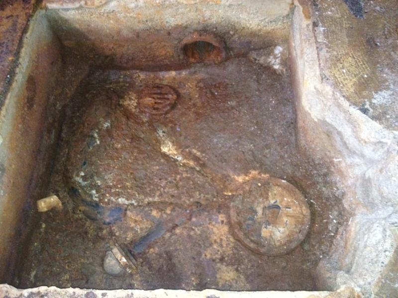

    hi guys, i recently bought a house and in the basement there is a hole in the concrete and in this hole there is two pipes that seem like they run around the house (i am guessing it is for the sump pump) there is a floor drain and there is a big pipe (i would say 6" in diameter). i am begining renovations and would need to know what it is and what i can do with it haha... and the pipes are about 3" bellow the grade of the basement floor.
    if anyone could help me figure out what these pipes are it would be greatlly appreciated!

    Buried around the perimeter of your concrete foundation footing will be "weeping tiles". These weeping tiles allow excess water in the ground around your basement walls to drain away (into the weeping tiles). That eliminates the hydrostatic pressure driving that ground water through your basement walls to make for a dryer basement.
    The weeping tiles will be connected to either a sump pit or "catch basin" in your concrete basement floor.
    If you have a sump pit, there should be a sump pump in it that pumps the water out of that pit. Depending on what your local codes require, the sump pump can pump the water onto your property somewhere, or into your house's waste water drainage piping.
    A catch basin is often called a "floor drain" cuz it's just a hole with a metal cover in your basement floor, most often near the area set aside for doing laundry. At the bottom of the catch basin will be a p-trap, and then a pipe connecting that p-trap to the main wastewater drain line from your house. In my building, a sump pump pumps the sump water into my building's waste water drainage piping. In both of my sister's houses, there are catch basins that flow into the main waste water drain lines from their homes. I suppose if you have twinned storm and sanitary sewers in your neighborhood, the local code might require water from the sump pit or catch basin to flow into the storm sewer instead of the sanitary sewer. That's something I don't know.
    The pipes from the weeping tiles will enter the sides of the catch basin. If you can see two pipes sticking up in your catch basin, I have no idea what they could be for.
    In both of my sister's houses, the stand pipe for their clothes washing machines is connected to the catch basin as well. That way, every time someone does laundry, the p-trap at the bottom of the catch basin gets refilled with water. Otherwise, if there's a long period with no rain, the water in that p-trap could evaporate and leave the trap empty. In that case, sewer gas could come wafting up into the house through that empty p-trap.
    If you plan to renovate your basement, you should allow for some way to access that catch basin.

    sorry iv been away with work but finally got back to the basement, here is a picture of my "whole in the basement".
    I should also add that I do have a sump pump installed at a different location

    from what I think I understand the pipe that is on the "wall" on the concrete slab in the wheeping tiles, there is another pipe just the same on the opposite side (can't see it in the picture). the floor drain would connect to the sewer system and this would drain if ever water came in thru the wheeling tiles (I have a sump pump so this isnt really necessary?). If all of this is correct does that mean the other big pipe is for a toilet?
    please give me any insight you might have. I am just trying to do this the right way but still want to get it done so that I can continue he rest of the basement
    thank you in advance for anymore answers!
