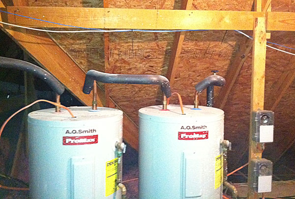

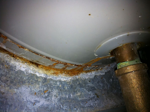

    We live in a home in TX constructed in 2006. There are 2 50-gallon AO Smith ProMax electric water heaters located side by side in the attic with a recirculation pump. We were on filtered well water the first two years (high iron content), and then we paid the money to get city water.
    Yesterday, I was in the attic and noticed rust around the bottom of one of the heaters. Is it time to replace these?
    If so, what brand would you recommend? Would you recommend something like the GE Geospring?
    I figure it would be best to replace both at the same time, if replacement of one is needed.
    One thing I never liked about our current setup is that we would get sediment/particles in our jacuzzi tub with hot water even after switching to city water. The faucet for the tub doesn't have a strainer, but I always wondered if it was our heaters or if it was related to buildup from when we did have well water.
    Thanks for the help and recommendations!
    Photos attached

    Looks like it's game time for the heater. If one is bad, can the other be far behind? Smith is not a recommended by the pro on this forum. GE/Rheem and Bradford White are the most preferred. I don't know what the feelings are about the GE Geospring. You should get some feedback on it. I have no advice about the sediment problem.
    12,605
    The rust from the faucet may be from the heaters. That's normally a first sign of the problem.
    2003 and ones leaking? I would go with replacement. Water does a lot of damage. It's much cheaper to keep everything dry.
    Jan 2008
    2,719
    When a heater leaks in an unfinished basement, it's no big deal. Not so true in an attic, where the potential for water damage is great.
    I suspect the threads might be leaking from where the plumber installed that brass nipple into the drain port. In any case, you will want to consider replacement and in the meanwhile check with your insurance company to make sure you are well-covered if one day one of your heaters lets out it's magic.

    2006? be sure to donate these to habitat for humanity or some poor folks, because very likely you simply have a seep from that replaced drain valve or a unnoticed seep from one of the top fittings.
    Move those 2 out of the attic, change the anode, FLUSH out the sediment, add a filter on the inlet, and you can get 10 more years. Check and see if the elements are seeping and change them out for a few bucks.
    http://www.waterheaterrescue.com/
    http://www.inspectapedia.com/plumbin..._Hot_Water.htm
    I would learn more about water heaters before treating them as disposable items.
    http://fierychill.com/catalogsearch/result/?q=anode
    And if you do blow a wad on new heaters, be sure the lucky plumber insulates the lines correctly.

    I appreciate the feedback. I had a local plumber out today that handles AO Smith warranty issues and he said the tank is leaking, that it needs to be replaced, and that AO Smith will cover the replacement (new tank, not labor). He agreed I should replace both simultaneously. He is going to give me the price of doing the job in the attic and also the price of doing the new setup in our garage.
    For safety, I'm going to get bids from 2 other plumbers and then depending on the price my wife and I will decide whether to keep everything in the attic or to move it to the garage.
    I'm thinking putting everything in the garage would be the intelligent decision.
