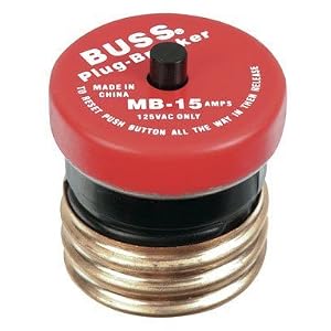

    My insurance broker said he couldn't underwrite the house if it had fuses anywhere. I told him it had one subpanel with 4 of the circuit breakers that screw in where the fuses go, and he said lets see what the insurance inspector says and issued the policy. If it's going to be a problem I'd rather get ahead of it and replace the panel now when things are slow. Anyone have experience with this issue?

    Made in China? No UL marking? My confidence level in that device just dropped to zero!

    Quote Originally Posted by kreemoweet View Post
    UL Listed
    http://www.acehardwareoutlet.com/Pro...aspx?SKU=31058

    Kreem, good catch, I guess those may be crap, but the metal shelled model I have here in my hand is UL listed, it doesn't say "made' anywhere but says Mechanical Products, Jackson MI.

    The way I see it, fuse boxes are a big problem since it is much easier to potentially overload the wiring. With a more modern CB panel, the average user won't just go in and change a CB to a larger one (which would likely overload the wiring). But, with a fuse panel, say it's a 15A circuit, and you only have a 20A fuse - you use that and then forget to replace it. Even with the CB fuse replacements, they can fail, same issue (assuming you have a spare).

    Jad, that is essentially, the reason why the insurance companies hates them. You are right on the money. A fuse is faster in shutting off an unsafe level of amps, but, melts ( inside of an insulator) and has to be replaced each time; and, like you said, can be replaced with the wrong size of fuse, whereas, with a breaker, when too much current flows through it trips slower, but, no mistake can be made in reseting it and no cost. It is simply a spring loaded contactor with 2 types of metals which bend to heat. Even these do not last forever, each time, it trips it is deteriorating the breaker. The insurance companies are tough on wanting to see an update at least done within the past 20 years. Or like going into an convenience store, ( no shoes, no shirt, no service)...They really mean NO fuses, NO boxes or NO insurance. I have even seen newer homes built with fuses, those poor people, they never take the news well & God only knows why, they built them like that.
