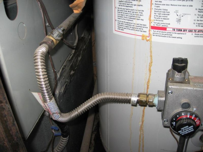

    Photo show gas line connecting to water heater.
    What material is this connecting gas line?

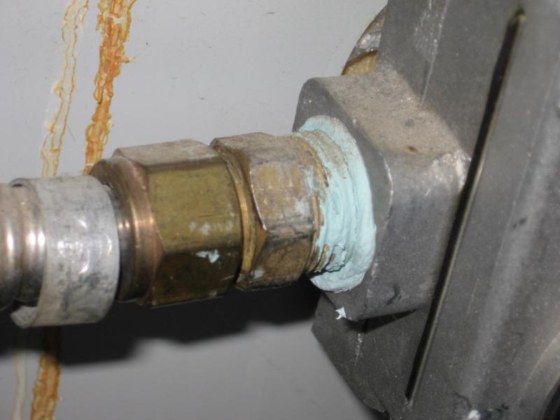

    What is this green stuff at the joint into the base of water heater.
    (Yes, I will request gas company to come out and check before turn on this gas line).

    On the threads, it's pipe dope - used to make the joint leakproof. I think the flexible pipe is stainless steel. If you're worried, you can make, or buy some leak detection liquid. Basically some soapy water - look for bubbles. You should be fine. Now, not sure about the rust stains on the tank's outer casing, that indicates a water leak and could be more problematic. Can't tell where it starts.
    14,207
    The gas line looks fine.
    Like Jim mentions, you can take a spray bottle and some soap. If there is any gas leaking, it will make bubbles.

    I measure the distance between the flat surfaces of the brass nut is 1 inch.
    Can you please tell me the size of the stainless steel flexible pipe?
    Does Home Depot or Lowes has longer replacement pipes? Also, do they sell end caps for this type & size of pipes?
    Thank you.
    25,659
    quote; Does Home Depot or Lowes has longer replacement pipes? Also, do they sell end caps for this type & size of pipes?
    Why would you need them, unless you plan on modifying the gas line? It is fine just the way it is, and the utility company will check and light the pilot when they turn the gas on.

    The flex lines are sold in various length, but as HJ points out, what you have is fine. There is no need for a longer line. Any time you drain a water heater, the heat source must be shut off. A 3/4" ball valve is a good investment. Take the plastic OEM and toss it. Be sure the tank is full before restoring heat. They do make a gas leak testing product, but regular dish soap works just fine. You can dilute it, but I use it straight out of the bottle. Pour it over the joint and watch for bubbles. No bubbles = no leak. Mainly, avoid cross threading and tighten the joints firmly and you should not have a leak. but test them anyway.
