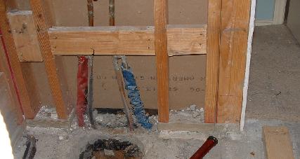

I am building a curb for a new tile shower. I want to screw a 2x4 into the slab to form the base of the curb. I'm really worried about hitting a copper pipe in the vicinity, as I will be drilling between the bathroom sink and the old tub/shower. Are there any precautions I can take to avoid hitting a copper pipe in my slab? Are copper pipes usually routed with only 90 degree bends? I will be using TapCon screws and be drilling down an inch or so.

you should have no problems as long as you don't penetrate the slab. The pipes shouldn't be running in the slab, they usually penetrate the slab and run in the base course under it.

I thought they ran underneath the slab, but I excavated about 2 square feet of the slab around the PVC drain pipe (replaced 1 1/2" with 2"). That hole was only a few inches away from where the copper pipes come up from the slab (I didn't escavate around the copper pipes). I can reach underneath the slab where the copper pipes should come out but I can't feel them. Maybe they are just at an angle? I live in South Texas and have heard of copper pipe slab leaks. I thought that meant a copper pipe within the slab had leaked.
I have attached a picture. The 2x4 on the right will be the new shower curb. There are actually 4 copper pipes. The sink and toilet are to the right. The street connection is further to the right.

The copper tube/pipes are under the concrete and in any case would never be within an inch of the surface. If they were it would be almost impossible to bend them to a vertical orientation, and fittings are never used under the slab. "Slab leaks" are leaks in the piping below the slab.
